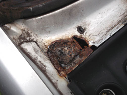

I have found some pretty bad corrsion on the chassis box section in the front wheel arch. i.e. behind the front shock and immediately above where the front suspension / body mounts. I would post a picture but it seems I am to much of newbie to have the privalages yet.
Having air chiseld away all the corroded rubbish I have an area approx 8"x3" with quite thin metal and holes I can get fingers inside the box section through.
My question is how best to patch this up ? Can I just attempt to MiG weld a patch over it all ? The orignal metal work was in couple of layers. If so how thick should the metal be in this area ? Is 2mm enough ? I have Oxy and a TiG welder but MiG is easier.
Any helpful suggestions short of sending the car to the crusher ?

Exactly the same corrosion damage was found in my 1999 XJR when the car was in anti-rust protection. I heard that it's very typ place for our cars. There were several damaged metal plates, which were replaced and now it's fine. I may ask from them how thick plates were used ( I remember that it was 2mm - but not sure... )

I just checked my car and I see only the beginnings of the corrosion you posted nurquhar. Do they salt the roads where you are? The type of rust I get is Hawaiian and costs a bit more (but it's worth it).

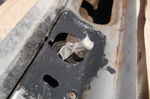

On my 1999 XJ8 there were two holes hidden under the long plastic cover in front of the windshield (see pics).
pic 1: the hole on the left side
pic 2: the hole on the right side
pic 3: the holes in the first two pics were filled with a foam probably put there for sound deadening. In this pic you can see the foam I removed from the right side hole (red arrow). It was quite a chunk and it was sopping wet. The left side hole was the same. Getting the foam out took some effort as it has adhesive qualities and was really glued in there. I ended up using a bread and butter knife that I sharpened and bent as needed to cut out the foam. Inside was a puddle and a rubber plug (green arrow). I took out the plug and it's all epoxy now. The yellow arrow points to a factory paint drip (see it ain't just me).
pic 4: I used to weld in patches but they always rusted out because the zinc galvanization was destroyed when grinding to bare metal. For the last about 10 years I've been cutting patches out of aluminum gutter which cuts easily and is very nice to work with. I make lots of holes in the area where the patch will overlap the good metal, and glue it in with a two part epoxy called PC-7. The epoxy comes up through the holes I drilled and locks it in. In a visible area I would glue it in from the inside. These repairs have stood up drastically better than welded repairs although of course I would not use this for anything that was structural!
pic 5: the right side patch is glued in with PC-7 and clamps hold the edge nicely. If you have to add some more PC-7 you can do it anytime but it works best to add coats while the earlier coats aren't cured so they bond better. I've done repairs around windshields with this method and it works well. I trust PC-7 more than paint on bare metal to prevent rust.
pic 6: here's the left side after painting. I used some POR-15 rust paint on places I couldn't remove all the rust from.
To cut the holes and for rust removal I use my Dremmel with fiberglass reinforced cut off discs. You can cut holes in a car and grind rust with those and they work great. I buy the discs from eBay, something like $15 for 100.
POR-15 is a unique product, a paint made especially to paint over rust (P-O-R, get it?) and dries best when it's humid which is odd. It's the only paint I know of that will not clean up with acetone.
If you get POR-15 on you it will clean up with Brake Clean. It's nice my car is silver as I've only seen it in silver, white and black. You need to topcoat POR-15 as it will get an odd dusty color. I bought several colors of Dupli-Color brand silver spray paint and the one for VW cars was the closest to my car which is paint code MDX.
When you put the lid back on the POR-15 can, it's best to put a piece of mylar (like a zip-lock baggie) over the can and then put the lid on. If not you'll likely never get the lid off. Then I masking tape around the lid, put the whole thing in a zip-lock baggie and store it in my freezer, more because it's dry than the temperature. POR-15 is a very unique product and the only thing I'd use on areas where there's rust I can't remove. It does work.
The holes I repaired are hidden by a plastic cover so they didn't need to look perfect.

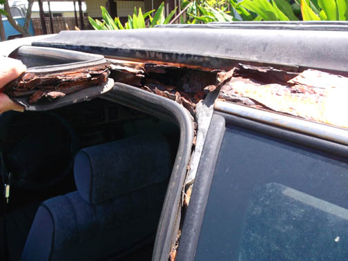

Check out the attached pic of me pulling back the door rubber on my '92 Caprice. It was brought here rust free from California about 6 years ago (what do you expect for $2000?). That's an eye opener pic, not? The car still rides beautifully at 215K mi, engine never been opened.
My chassis rust is on just one side. It looks like during manufacture they left a bit of gap where the wheel arch panal comes up and overlaps the chassis box section. The two parts were spot welded together. However without sealant sealing the seem water has got in between the plates and rotted from within. Thus you realy notice the problem when its worked its way from the inside to the outside.
I have a local welder coming to see it today as it needs to be a proper job being structural. I don't want to risk not getting a decent weld down first time onto solid metal. I am quite happy welding new metal on the bench but dangeling under a car at funny angles with hot underseal dripping on you is a lot more challangening. (been there and got the T shirt).

Got the welding done yesterday. Had a great bloke round to do it who was an ex Rover panel worker/welder. It took him 2 hours to clean up the site and put in a double skin patch over the area. The work cost £70 which I thought was pretty reasonable. The job was nice and neat, I would recommend Ernie.
