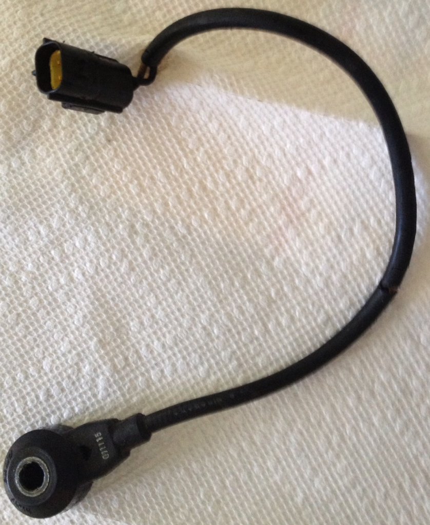

Ok - I got it out! I'll post photos in a minute, just wanted to say thanks again -- I had looked and looked at those photos and couldn't figure out the "trick." I was being overly cautious as well so as not to break anything. Finally, I went to the hardware store and got a piece of brass (all I could find in the "right size") bar and bent the end of it. After probing in the correct spot, it came loose. The rest was a matter of using the wire trick to remove it.
Now at least I know what I had in there!
Here are the photos -- the second one is a close-up of the broken cable sheath -- the wires look ok, but the rubber sheath is cracked open. This wasn't done by me!
Now I need a new one and with all the great help here, I can get it installed as soon as it is delivered.
You guys have been a great help. I can usually do stuff by myself, but when I haven't done or seen it done before, I am extra cautious.
BTW Great tip in the write-up to use grease inside the socket -- first time I've heard of that trick and will definitely use it again!
Also, BTW -- the nut was screwed on so tight I could hardly loosen it with my ratchet! I won't be hefting down on it like that when I install the new one.

Jim - you might've missed my post -- I got it out, finally! Guess I was being too careful.
After getting it out, I decided to tape up the wire and put it back in (you never know!). It took no time at all to maneuver it onto the stud and fish the wire through to the t-stat tower. I hooked it up (but didn't clip it onto the tower!) and started up the car. No restricted performance message until I moved my other car out of the way and started the XJ8 again -- now I have the message again. It was worth a try! Also, the practice putting it in and taking it out was well worth the effort. Now I feel as though I'll have no problem putting a new one in.
Now all I have to do is order one! (edit: have it on order from rockauto.com $26 and change incl shipping)
Thanks a million for all your help.
