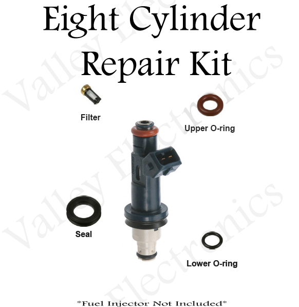

Now he tells me that the part he needs is the seal/o-ring or whatever it's called that is between the manifold and the injector -- bad news -- that part is not available so I need 8 new fuel injectors at $200 a piece!

He already replaced the injector o-rings. The part he now needs is the injector to intake manifold seal (not the manifold gaskets, those have also been replaced). I'll try to find out exactly what it's called, or a get a photo and post it tomorrow.

Please get a photo. I looked at the injectors on the parts catalog and there is only the upper and lower orings for the injectors. The ends of the rails have orings for the crossover pipe.

If you click on the ebay link in Jim's post, the part I need is the "seal" that is pictured to the left in the photo. I truly don't understand why, but that's what I need right now. I'm pretty sure the injectors are okay, unless one or more broke when the mechanic took them out!
I might just have to order that kit (which includes stuff I don't need) or I'll have to get new or remanufactured injectors.

I am not seeing this other seal -- I only see the two?

The photo I was referring to above is this one - the part labeled "seal" is the one (8) I need.
Yes, we're chasing a vacuum leak. This all started out with me trying to replace my t-stat, etc. and causing more damage!
I ordered the kit for $33 and will see if the seals work. If not, all that is lost is some time and $33.

It's the same seal i linked to in my post... i win!

Nice to know those seals can be had. I of course, can't get them from Jaguar, but they are so seldom needed that is wasn't a big deal. Hence my question as to why they were needed here.

Long story short -- reinstalling the injectors eliminated the leak, now I need a knock sensor!
