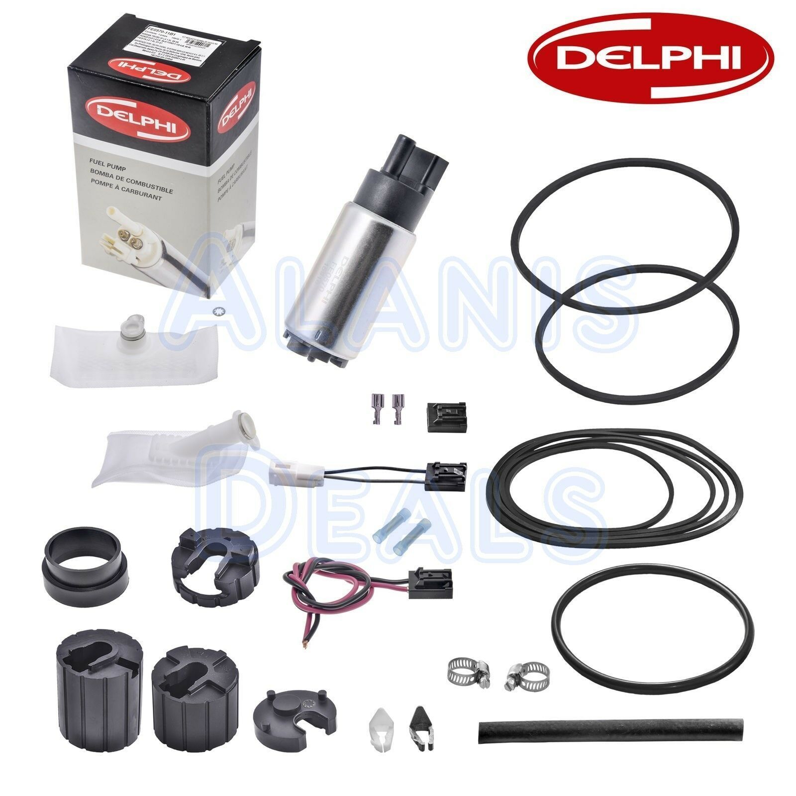

Went out to the ride a week ago & wentf or a warm up in this cold south dakota weather... Boom fire up then died...Went thru the process relays, fuses, checking power the works. Finally threw the pressure tester on the rail. & NOTHING. & Not to mention the car ran fine when i parked it about 8hrs. earlier. So after spending so time on here (As i always do when it decides it needs something new) I looked around for pump recommendations. The Airtex E2471 seems to be the most popular... So being that i've been a side-job wrencher foryears now i remember seeing that in a cross ref. guide for a Delphi pump Sure enough i was right model #DEL38-K4014 drop in replacement no splicing or anything (used the factory rubbers for the new pumps as well. Flow-rate & specs. match or exceed the factory specs.Just figured it'd come on & throw another option out there!!! both pumps @ the cost of $58. & a couple hours of my time.. Much thanks to everyone on here

I replaced the pumps in my "R" in October. After searching around I also settled on the Delphi pump. The factory rubber isolators required very minor adjustment with an Exacto knife. I liked the fact that the electrical plugs were already attached as the idea of splices in the fuel tank was not appealing. I purchased the pumps and the filter socks from Rock Auto (much less expensive than the same thing from Auto Zone, even with shipping). I went in through the parcel shelf...I'm an old geezer and don't have a lift. I'm sure it took just as long as pulling the tank, but it was less muscle involved. And if it happens again, the top down method will be a snap.

Found the Delphi DEL38-K4014 complete kit for $26 & just had to pounce on it lol.
