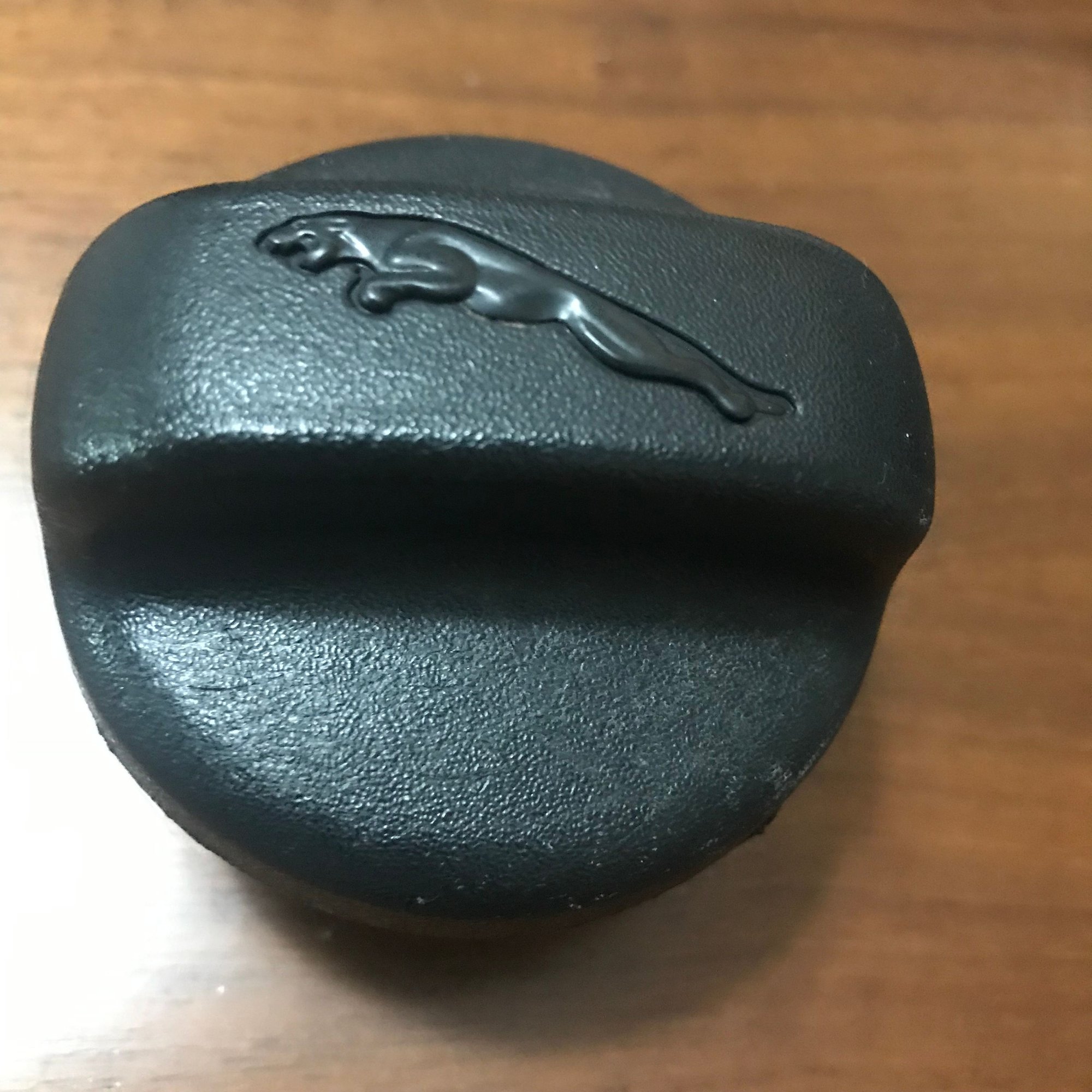

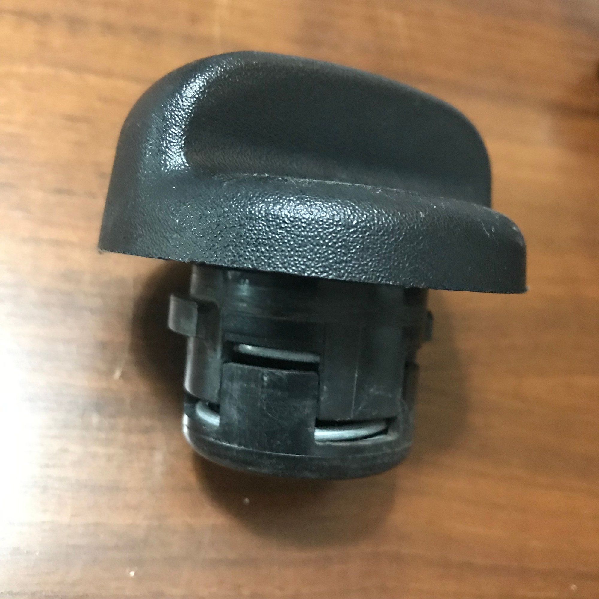

Is this the right part number for my 1999 XJ8 Base? Sorry I was not able to take a photo.
It looks different from the one in my car when I bought it. Which is this one below.

I think the old type (as per your picture) was a NMB5942AA, which was superseded by NNG5942BB (up to year 2000) and NNG5842AG (for 2001-2003)
The later two types look a little "sleeker" but I'm betting any will fit and work fine.

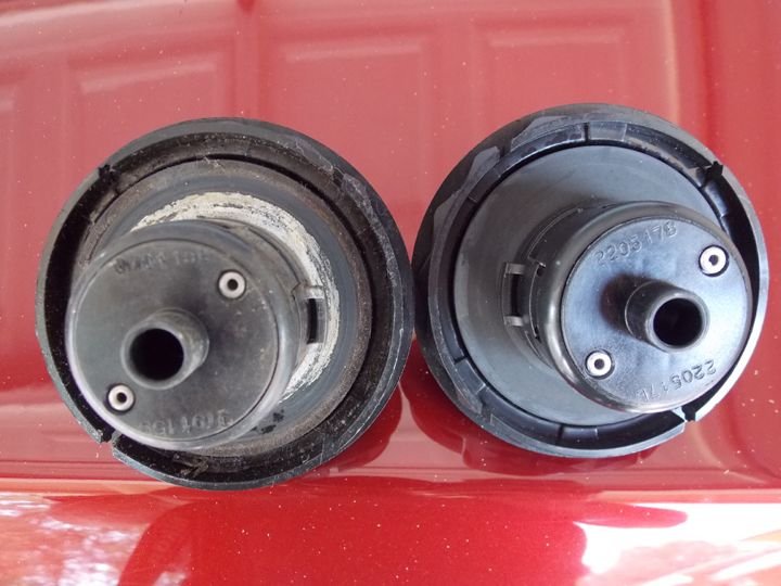

Old Aug 13, 2019 | 04:43 PM
King Charles's Avatar
Posts: 4,513
Likes: 1,028
From: North Carolina,USA

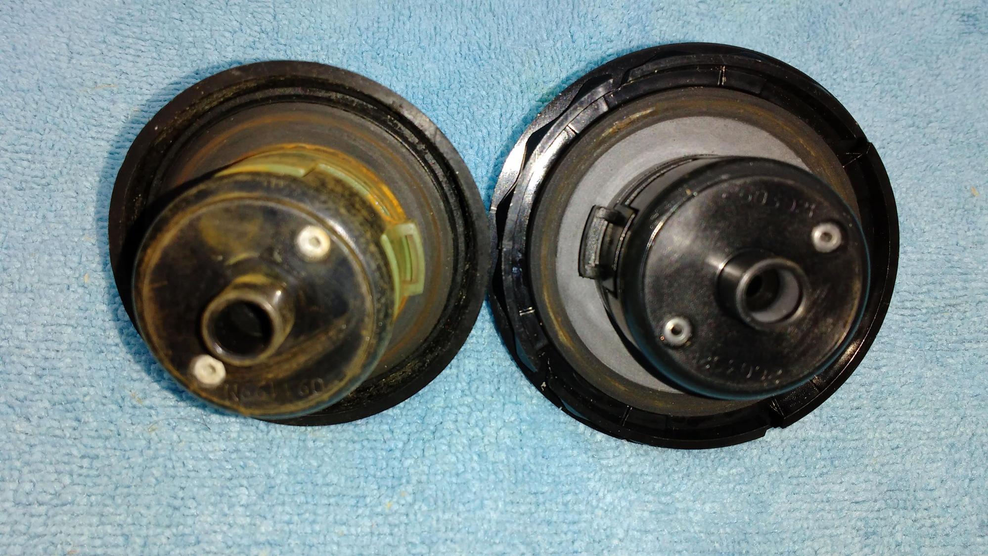

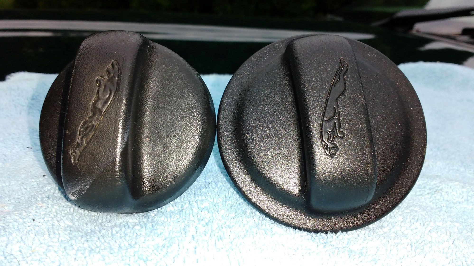

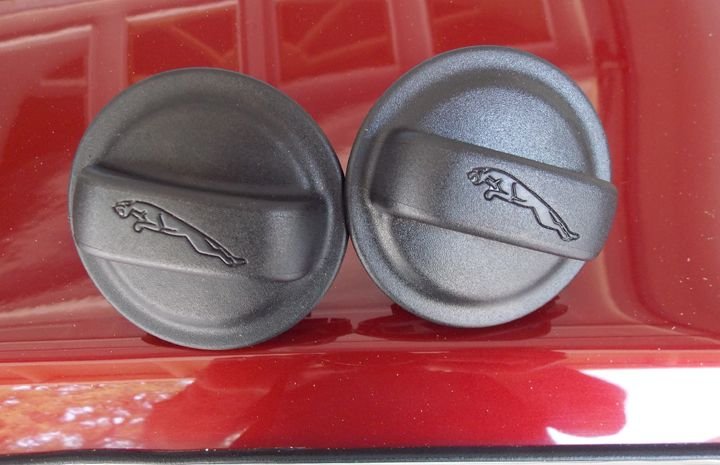

I replaced mine w/ NNG5942BA which was listed as compatible for XJ6 (91-97) XJ8 (98-03) XK8 (97-00) & has been perfect thus far.
https://www.ebay.com/itm/Jaguar-XJ6-...A/311717659766
Superseded Part Number: NNG5942AC, NNG5942AD, NNG5942AF, NNG5942AE, NNG5942AG
Other Part Number: NNG5942AC, NNG5942AD, NNG5942AF, NNG5942AE
Interchange Part Number: NNG5942AC, NNG5942AD, NNG5942AF, NNG5942AE, NNG5942AG
I got mine from Welsh on eBay linked above & they've never steered me wrong w/ parts before. Here's the comparison pic between the 2, my new one(on the right) has a bigger footprint.
