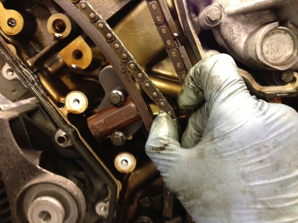

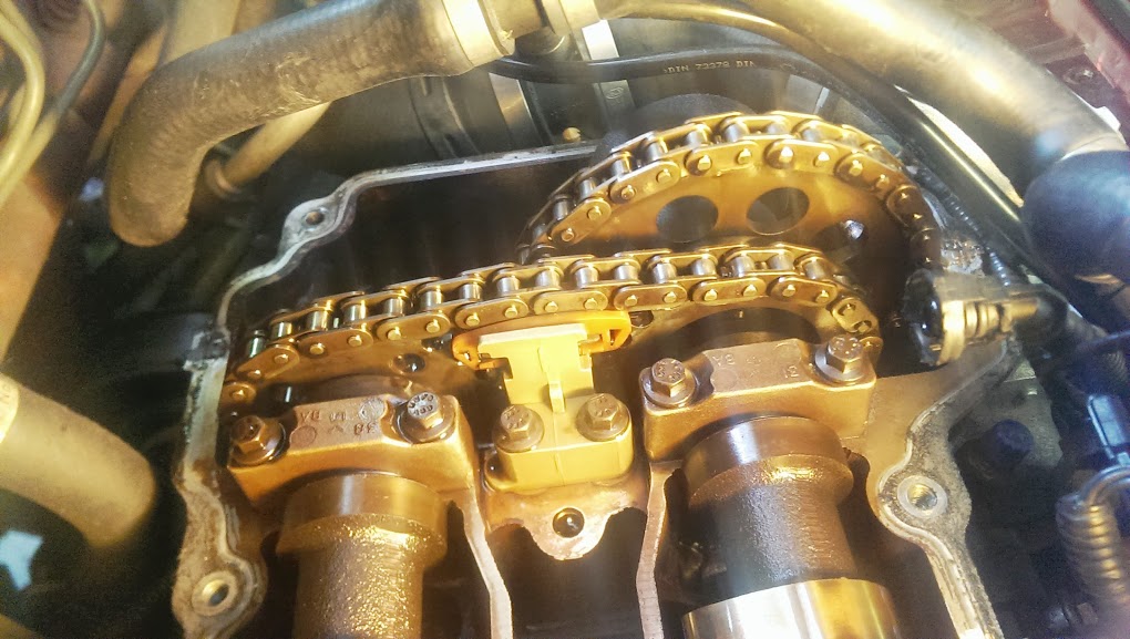

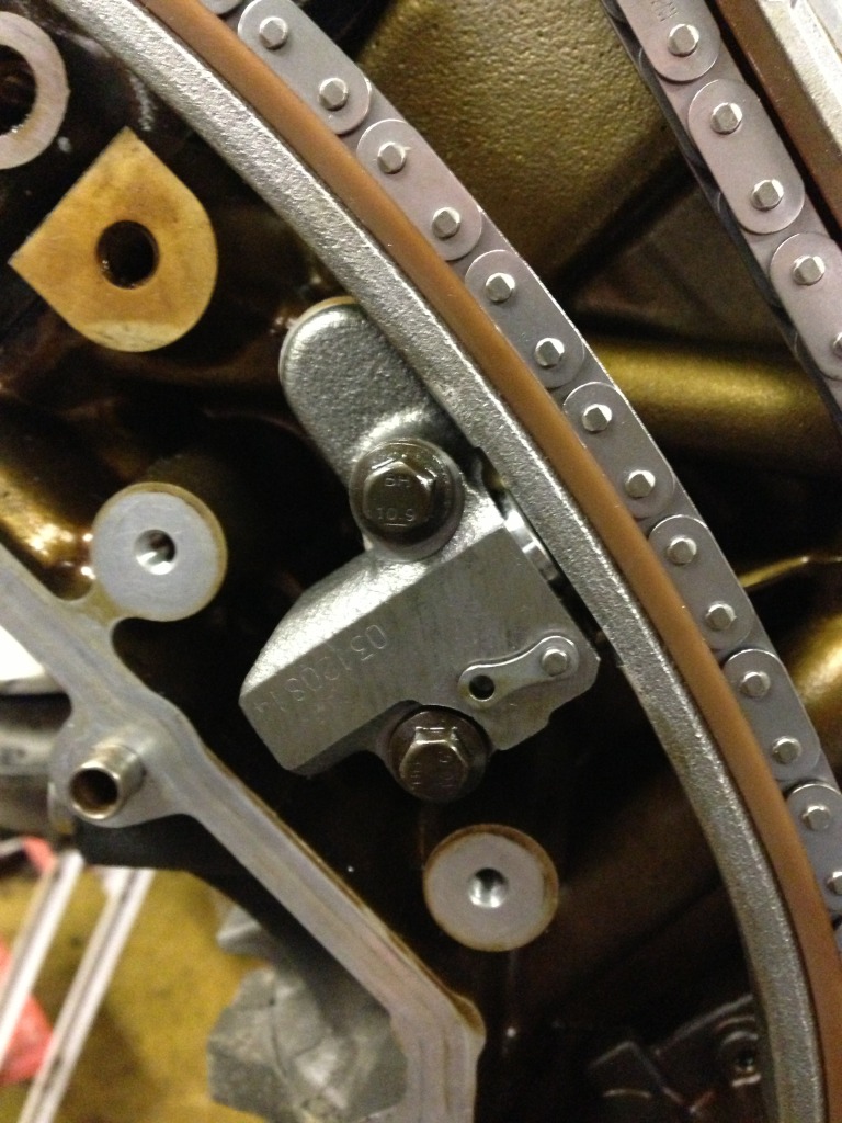

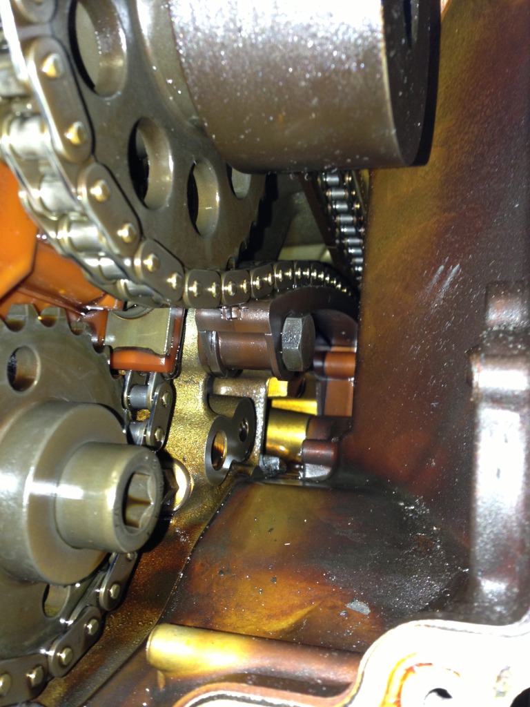

Well, in the spirit of 'a picture says a thousand words'...
Here's the left side:
...and here's the right:
...and here's me trying to take a picture of the right-hand primary chain guide that I thought was metal:
...and the same pic of the left:
Some things that look weird to me:
1) In the second pic, the secondary chain is flat across the tensioner and it's being pushed "up" in the first pic. I couldn't feel any spring pressure in either side.
2) The primary chain on the left side is noticeably loose. If I reach down and flex it near the guide, I can deflect it 5-6mm. The right side primary chain is tight.
3) In the fourth pic (showing the primary chain that's loose), the guide looks.. well.. different. Is it *supposed* to look like that?
Thanks again for your responses so far. My expertise is in Rover v8s and old Triumphs, so a lot of this is new to me.

I can speak to the difference in the two sides. Remember, both chains are running on sprockets turning in the same direction and the intake cam is pulling the exhaust cam with the chain. So, on the left side, it pulls on the bottom and the slack side of the chain is up. On the right, pull is on the top and the slack side is down. The tensioner pulls up the slack side and is only a slipper plate for the tight side.
I am not sure I remember what the original primary guides look like (my replacements are different) but I THINK yours MIGHT be missing all of the plastic piece. You could drain the oil through a strainer and see if you find some plastic chunks!

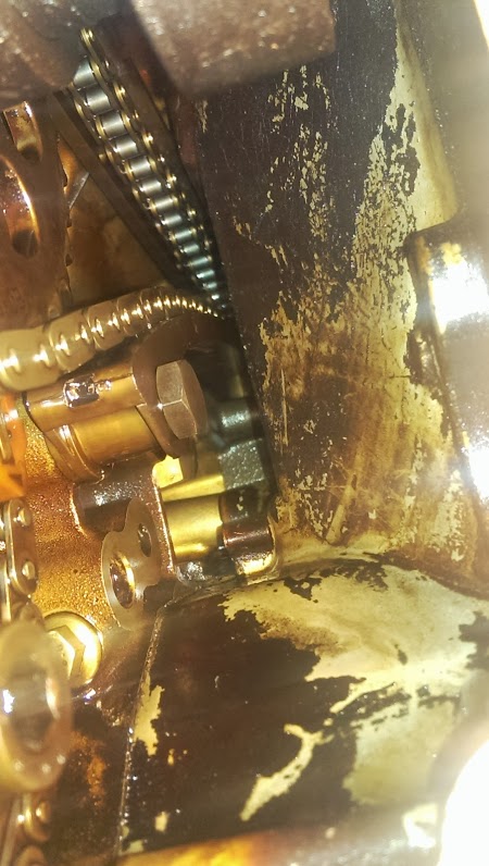

I am going through this right now, my lower RH tensioner failed, causing lots of slack, but only at certain spots in the rotation due to the loading of the chain caused by the valve springs and cams.
Your lower guides look just like my original ones. The latest ones look quite different, seen here.
[IMG][/IMG]
And my original ones.
[IMG][/IMG]
Notice how the tensioner piston is bottomed out. There is a check valve inside that traps the oil to keep the chain tight when the engine is shut down. It rattles on start until the oil pressure pushes out the piston.
[IMG][/IMG]
