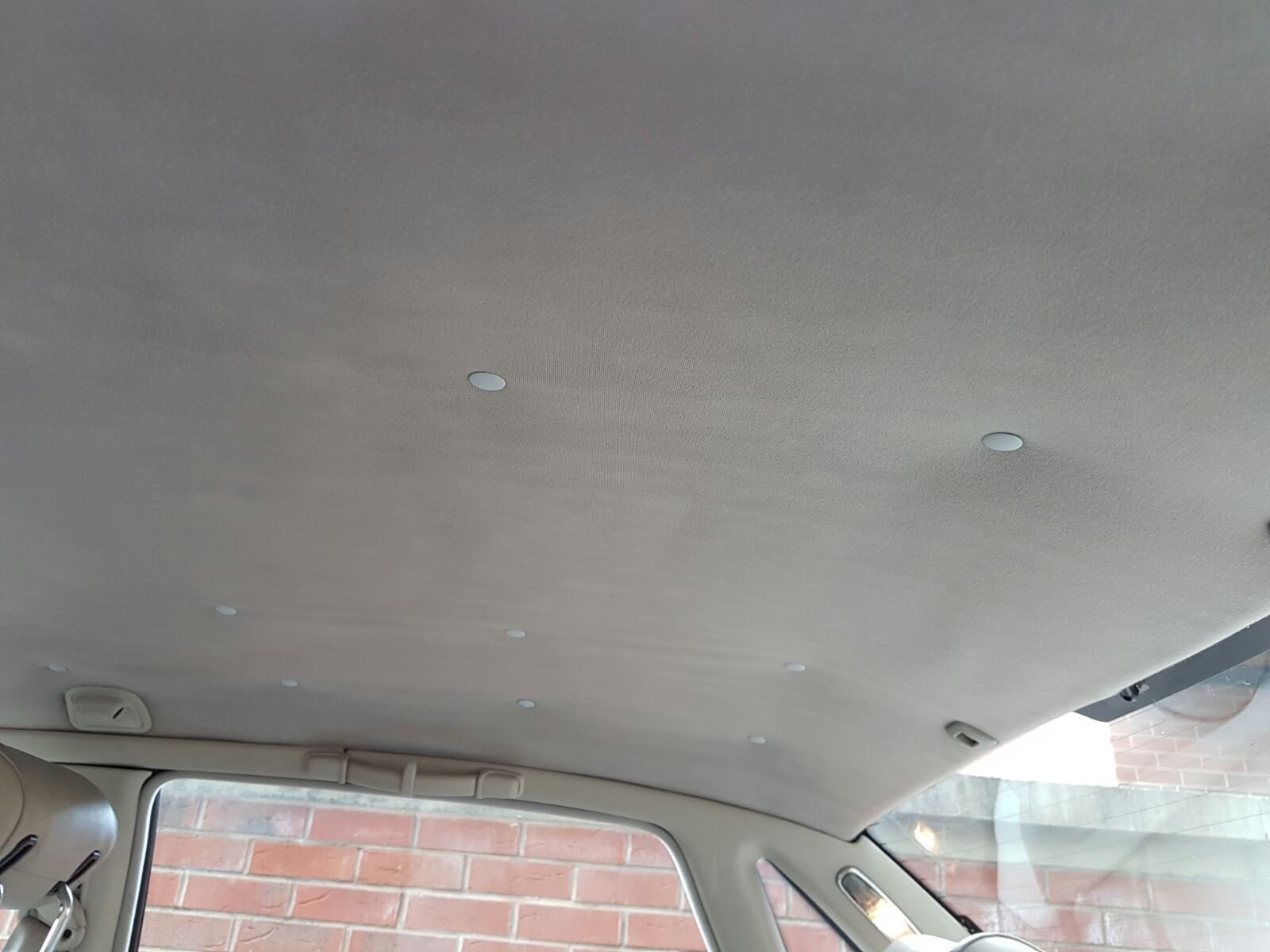

The magnets would have to be really strong to stick to the roof through the fibreglass panel the material is fixed to. When I bought my XJ Sport, the previous owner had proudly "fixed" the sagging roof liner by having "fir trees" inserted to hold up the material. He thought it looked very nice, I thought it looked like a bad sofa from the mid 70's, plus it was stained from tobacco smoke from one of the previous owners. Thankfully I had the roof liner out of my old XJ which I had recovered with new material and stuck on with modern temperature resistant glue by a professional trimmer.
Here's a photo of what the roof looked like.
What's that thing on the ceiling above your B pillar? Mine doesn't have that...
It's the interior motion sensors for the alarm system, there's one on the other side too. The USA got a very basic security for some reason whereas the uk cars got a comprehensive system including tilt sensor, secondary back up alarm and double locking feature.
