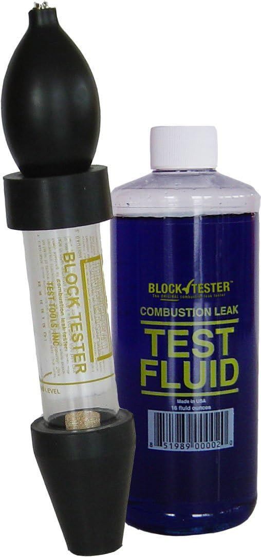

Is the underside of your oil filler cap coated with a milky goo?
If a scan tool reports misfire codes in one or more cylinders, that is a clue.
With an inexpensive chemical test kit like the one shown below, you can test for exhaust gasses in the coolant, which would confirm head gasket failure:
Amazon Amazon
To confirm at which cylinder or cylinders the head gasket has failed, you can pull and inspect the spark plugs - a really clean plug is a clue that coolant is steam-cleaning the plug.
If you have an endoscope, inspect the tops of the pistons - a clean piston is being steam-cleaned by coolant.
If that is inconclusive, a compresssion test may confirm the failed cylinder or pair of cylinders.
You can also pressurize the cooling system with a test kit and look for coolant leaking into any cylinder.

thank you for the response. I’ll check the car when I get back home I’ll give a response in about 2-3 hours. I have plugged in an obd scanner that’s showing cylinder 7 and 8 misfire is this an indicator that it’s probably those cylinders? Thank you

Yes, that's a good clue that the leak is between cylinders 7 & 8:
On your 2000, what your scan tool is calling cylinders 7 and 8 are probably what Jaguar referred to at the time as cylinders (2)-3 and (2-4), or cylinders 3 and 4 in Bank 2, or the left bank as viewed from the driver's seat.
