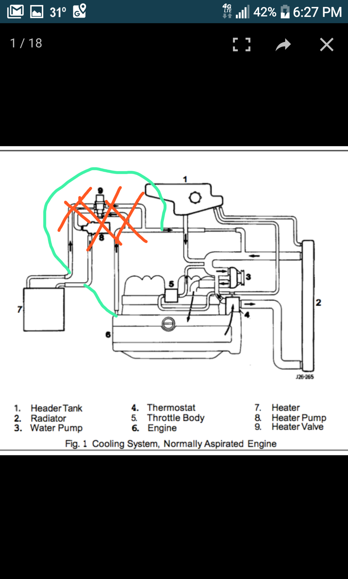

I had no heat as well and it was the pump, rather than getting the costly pump replaced i butchered up the already existing coolent hoses and rerouted everything to completely bypass the valve and pump.
The picture attached shows my method of ensuring flow through the heater core. Hopefully the engine is alright with it xD

Outcome is fantastic heat and the engine is staying at proper operating temp! I can feel my fingers again!!!
Who'd a knew a parking lot mechanic could figure out a better way of getting coolent to the heater core than with an external electric pump? Now what to do once summer comes around....
