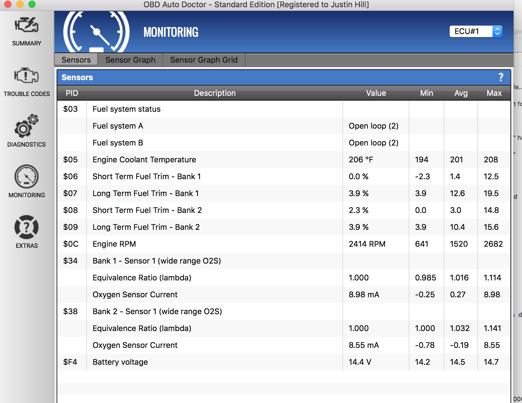

I had a quick go with the new scanner setup - more just seeing how it worked than doing any real analysis.
I did capture this (attached), which shows lambda of 1.079 on bank A and 1.03 on bank B. Total fuel trim on bank A is 10.2%, bank B 5.4%. The engine has only just got warm however. Could it be that the ECM is still getting used to the new sensor? These figures are better than what I was seeing yesterday so maybe I should risk a test drive tomorrow to see if things improve further.

Using the new software I could see that the more I ran the engine, the better the figures seemed to get.
So, despite breaking the law (since the car isn't taxed) I went for a 50 mile round trip involving some country roads and a stretch of the M23.
When I got back, the results looked like this: (attached).
Without an appointment and brandishing a hard copy of that I went round the MOT place. After scratching their chins for a few moments they let me back the car up to the machine - and it passed. The machine read
