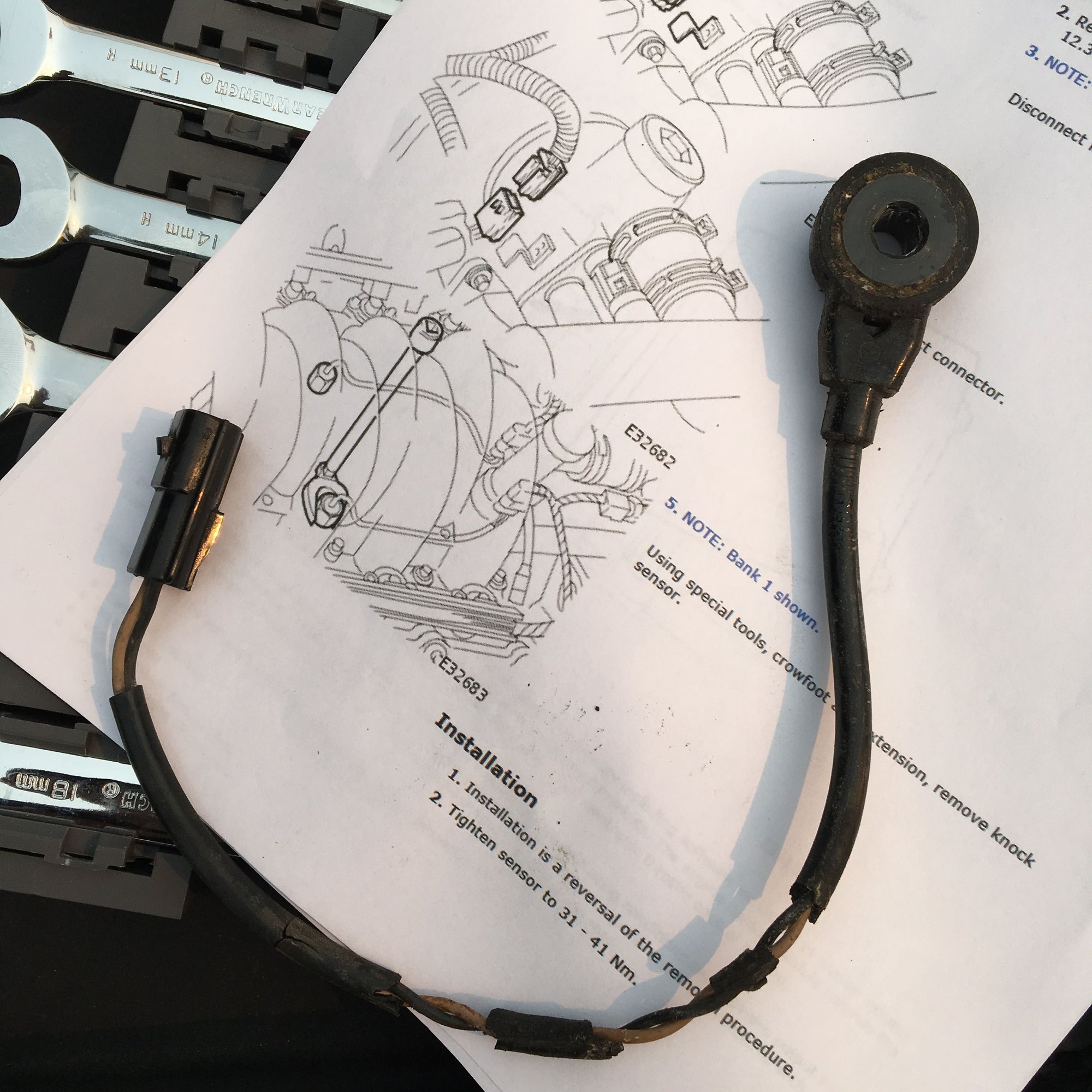

Removed the driver side knock sensor. Thoughts?

Apart from the protective sleeve are the wires shot? If not and are flexible, put a meter on them, they should Ohm out at around 200K I think. They only report a fault when the engine 'pinks', so chase the air leak and or faulty MAF. Be careful not to drop the knock sensors as there's a fragile crystal in there (Dilithium....probably )
