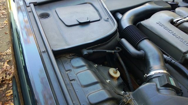

Can you tell me exactly where is the battery post located on the firewall?
Better still, positing a picture would be worth a thousand words. Thanks!
The positive has that rubber cap over it, the single wire that's mounted just beneath the cover. You can ground it wherever, but should only need to hook up for a moment or two while you press the button.
EDIT: I'm not sure offhand if the location is different between the XJR and XJ8, but here's a video on youtube from a 98 XJ8

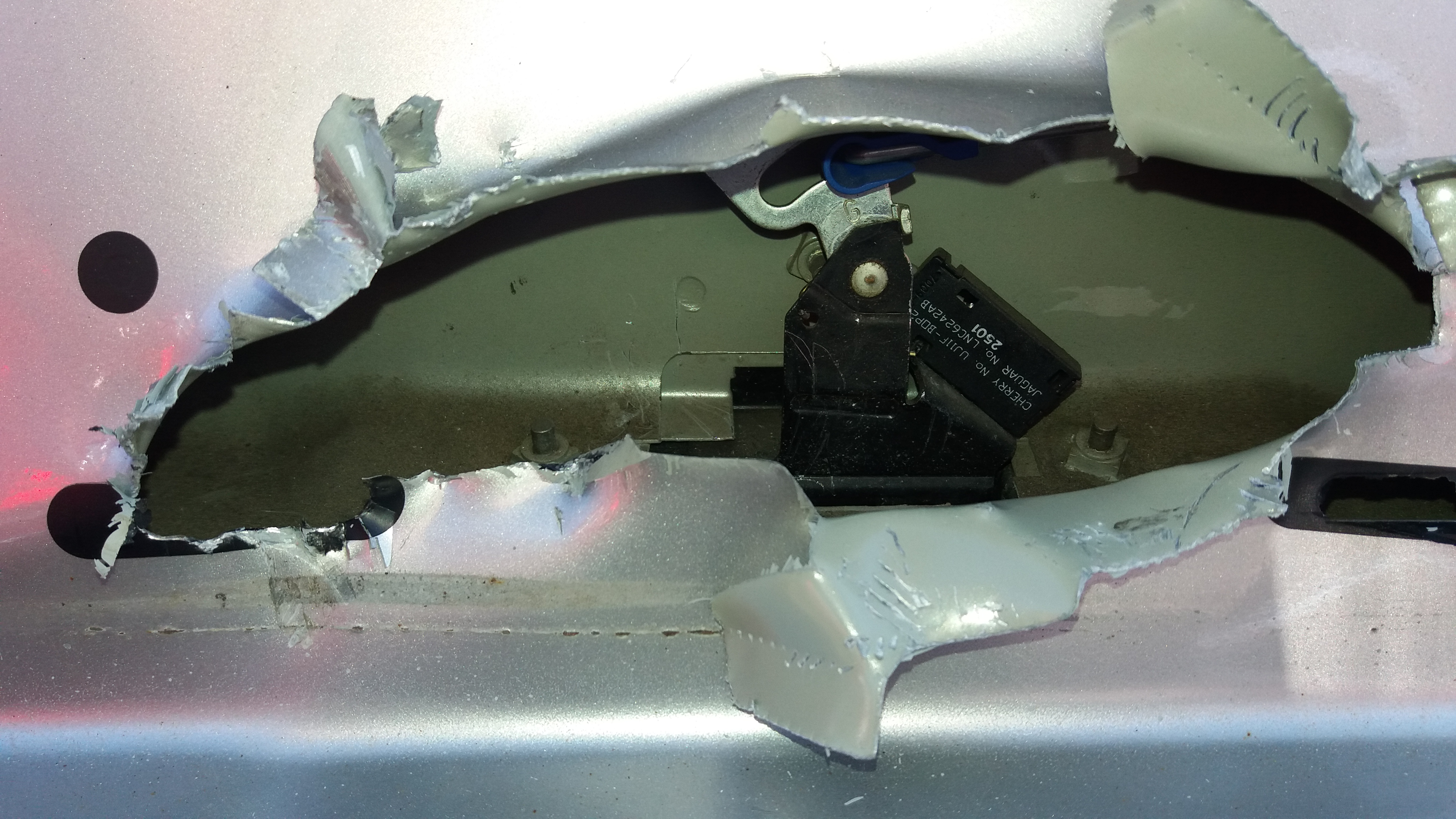

nilanium's Avatar
Joined: Oct 2014
Posts: 1,465
Likes: 515
From: MD, USA
Here's an idea of the layout of the release mechanism guts behind the license plate panel (don't judge me, it was a wrecked junkyard x308 at the local pick n pull)
Attached Thumbnails HELP: X308 trunk will not open-trunk_release.jpg
From a Jack Nicholson movie , The Shining , with the ax and smile . " Ohhhhhhhhhh , there's the bunny "
