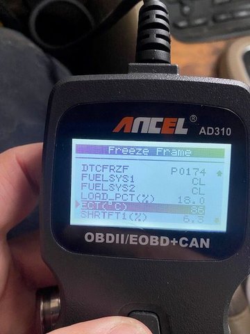

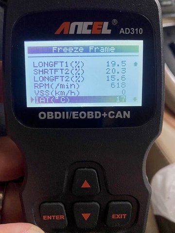

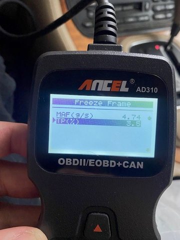

STFT 1 = Short Term Fuel Trim.
The ‘1’ is for Bank 1
STFT 2 is like above but, for bank 2.
LTFT 1 & 2 is Long Term Fuel Trim bank 1 & 2.
LTFT is a much slower responding fuel trim adjustment.
STFT is a much faster responding fuel trim reading.
The LTFT is considered ok if it’s in the -10% to +10% range.
Your LTFT’s for both banks are above the threshold. This means overall that your ECM is trying to add more fuel. There are *many* reasons that can cause the P0171/174 B1&2 lean codes. Vacuum leaks in the air intake tube, intake manifold gaskets, dirty MAF (or just about all aftermarket MAF) sensors, vacuum leaks in the part load breather tube, full load breather tube, brake booster vacuum pipe leaking air from the o ring inside the brass insert under the throttle body, low fuel pressure, clogged fuel filter, no o ring on top of the engine oil dipstick. You get the idea. There’s many ways to have a vacuum leak, faulty MAF sensor or low fuel pressure to cause these codes.

Fortunately you kept the original one. You must clean the resistors down inside the tube. If they look dark or fuzzy, that’s going to contribute to the lean codes. The single ‘bulb’ like thingy is the incoming air temperature sensor. I’ve used brake cleaner and compressed air on hundreds of those MAF’s and never had a problem. If it makes you feel better, get actual MAF sensor cleaner and be liberal with it. To answer your question, the LTFT’s should come down *IF* the aftermarket MAF sensor changed to the original cleaned Denso sensor makes a difference. I know there is a set value for the MAF grams per second reading but, I don’t know the exact number. Just clean the original Denso sensor first then re-evaluate. Maybe go drive it a bit if you can.
