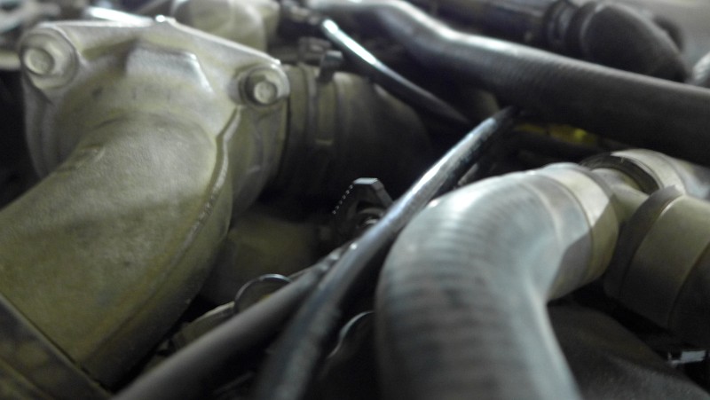

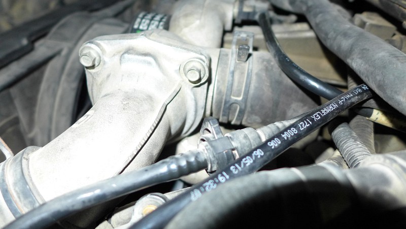

Is this it? See pictures ...
But how do you remove it? I tried pulling it off, it seems to be one piece completely surrounding the pipe, like an O shape not a C shape.
Attached Thumbnails ho do I disconnect the plastic hose attached to the reservoir?-p1160355-800x451-90-5.jpg   ho do I disconnect the plastic hose attached to the reservoir?-p1160359-800x451-90-5.jpg   ho do I disconnect the plastic hose attached to the reservoir?-p1160362-800x451-90-5.jpg

margate69's Avatar
Join Date: Jun 2012
Location: San Francisco, Ca
Posts: 97
Received 30 Likes on 20 Posts
HEHE. I take them every time I change one of those breather hoses off the left bank, front of the camshaft cover. I must have 10 in my tool box.

Old 05-08-2015, 06:21 PM
Auspuff's Avatar
Join Date: Apr 2015
Location: Antarctica
Posts: 55
Received 24 Likes on 8 Posts
How do you remove the special tool?
Old 05-08-2015, 06:41 PM
margate69's Avatar
Join Date: Jun 2012
Posts: 97
It has locking tabs on it, so you disconnect the breather hose from the left bank, take the little tool out, reinstall the hose to the cam cover, and cut the locking tabs off. I suggest attaching a zip-tie to it, just to make it a bit bigger, they're easy to lose.
Old 05-09-2015, 11:19 AM
Auspuff's Avatar
Join Date: Apr 2015
Posts: 55
Wait, what? You have to detach one end of the breather tube to get access to the special tool which you use to detach the end of the breather tube ...
How does someone at Jaguar HQ design department even think of doing something like that, let alone why it makes more sense than just sticking it in the toolbox under the bonnet ?
I'll look again later maybe I've missed something obvious.

Old 05-17-2015, 10:33 PM
Platinum XJR's Avatar
Join Date: Sep 2013
Posts: 379
Received 50 Likes on 39 Posts
I need to know this as well.
Old 11-13-2016, 12:48 PM
CharlzO's Avatar
Join Date: Feb 2015
Location: Upstate NY
Posts: 999
Received 258 Likes on 210 Posts
Late to this party but since I'm in the same boat now, I thought I'd put this out there.
The clip that is the "full" one, that was pictured above in place, does NOT fit the connections on the reservoir. I was able to snip mine free today and sure enough, nothing. It's not wide enough. So where it is in place, appears to be the only connection it even fits, as the rest of those clip connectors are all a larger diameter.
For the record, I couldn't get the brad squeeze to work at all, perhaps I wasn't using long enough ones, and using pliers I was able to get one side of one clip even remotely close to releasing.
Lucky for me though, that stupid little tool should only run what, $20 for a piece of plastic that serves one purpose and cost about 23 cents to make? yay... looks like no heat for another week.
