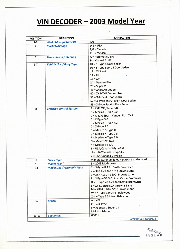

Jaguar published 3 decodes for the X308 and they are different! I posted all the Jaguar decodes in this thread:
https://www.jaguarforums.com/forum/g...tables-145996/
The VIN you quoted SAJDA25B82MF49790 appears to decode from the generic 2003MY table:
SAJ (World Manufacturer ID) = Jaguar
D (Market/Airbags) = USA
A (Transmission/Steering) = Automatic/LHS
25 (Vehicle Line/Body Line) = Super V8
B (Emission Control System) = XJR/Super V8
8 (Check Digit) = Validates VIN
2 (Model Year) = 2002
M (Model Line/Assembly Plant) = XJR 4.0 litre S/C, Browns Lane
F (Model) = XJ Sedan/Super V8
49790 (Sequential) = Individual Vehicle Number
