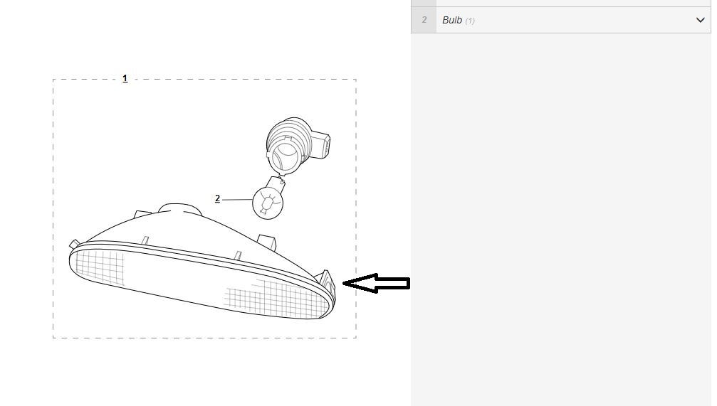

hi all I ask for information on how to disassemble lateral indicators, there is already a video or a discussion on this?

I'm not sure which lens you are working on but they both remove the same way. I have attached pics of both. You push on the side without the lock tab. I marked lock tab with arrow. Side markers push from the front of the vehicle towards the rear. The fronts push from inboard towards the fenders.
