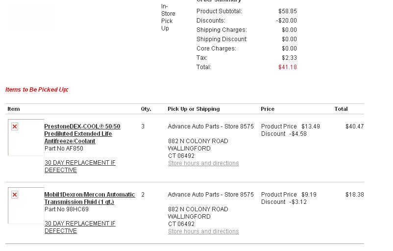

Hi SirJag
As you know last week we had a 100,000 maintenance done on 2001 XJ8.
Here is a JPEG file of the coolant and steering fluid I purcased from Advance Auto Parts with a big discount (3 gallons of coolant - use a little over 2 gallons of it). This discount code A123 is only good through April 15th.
How Much Anti-Freeze to Do a Flush & Fill?-coolant-steering-fluid-flushes.jpg
Jim Lombardi

Default I paid $9 per Gallon for Coolant 50/50 at Advance Auto Parts
Hi
It was only $8.91 per gallon for Preston Dexcool at Advance Auto Parts with promotion code.
See the previous posting.
Also the ATF fluid for the Power Steering was only $6.07 per quart.
Our mechanic used the 50/50 coolant to do the flush. Apparently he felt the use of the full concentate was not necessary.
Alldata information about Coolant capacity is 10 liters (10.6 quarts). Our mechanic used a little more than 2 gallons of 50/50 to flush and refill the cooling system.
Power Steering Fluid capacity is 1 quart. Alldata shows type as Mobil ATF to Dexron 3 Specification.
Our mechanic used 2 quarts to flush and refill.
Jim Lombardi
