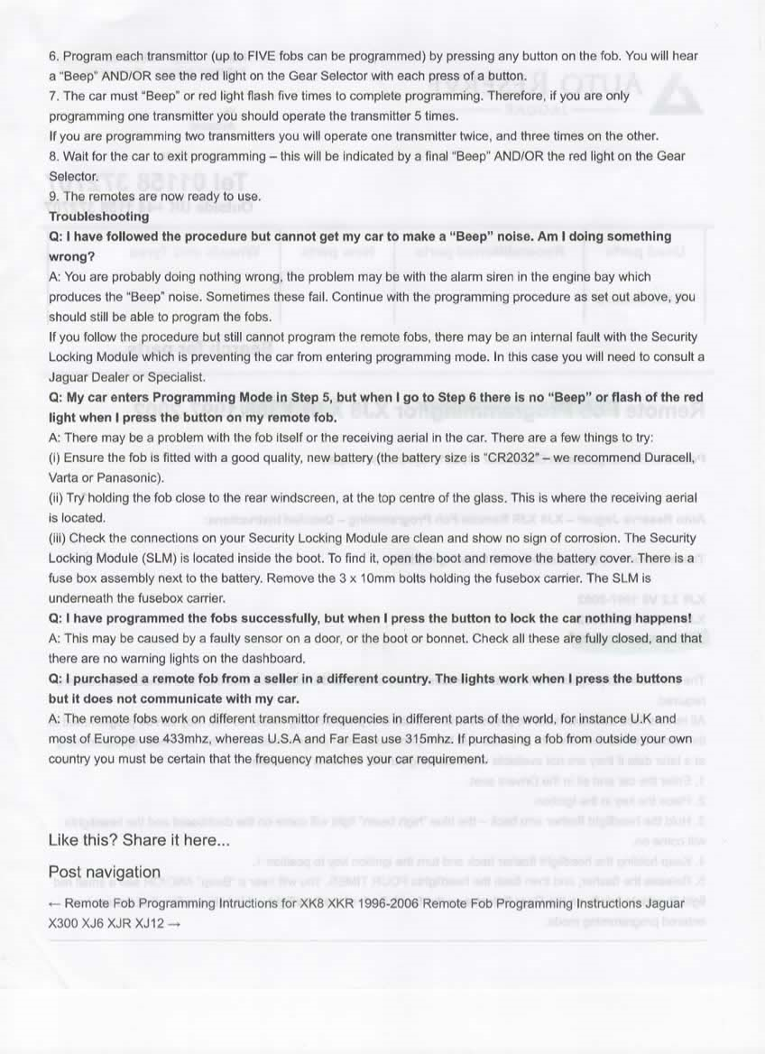

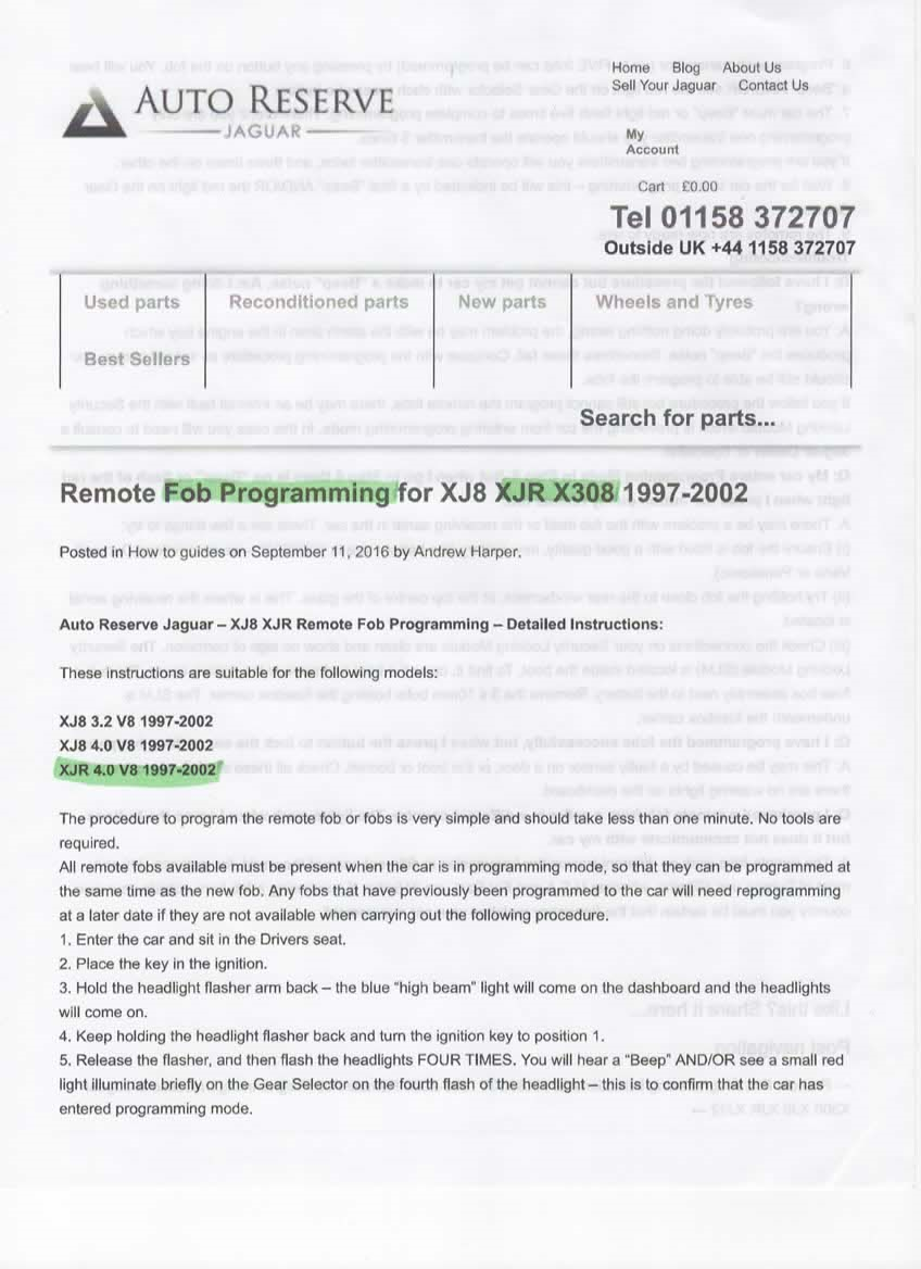

Procedure for programming key fob
Old Jul 21, 2022 | 04:57 PM
Ken Cantor's Avatar
Joined: Mar 2022
Posts: 4,577
Likes: 4,188
While it might seem a bit finicky, it really does work as simply as it's represented to. You do need to program all of your fobs (i.e. you'll also have to "reprogram" your current one if you're programming a second one) and you do need to pay attention to the number of beeps and to the number of times you operate each transmitter exactly in the sequence noted or the programming won't take.
I programmed a new fob and reprogrammed an old one a month ago and they have both worked flawlessly since. Good luck.
Attached Thumbnails How to program keyfob-scan_20220721.png   How to program keyfob-scan_20220721-2-.png
