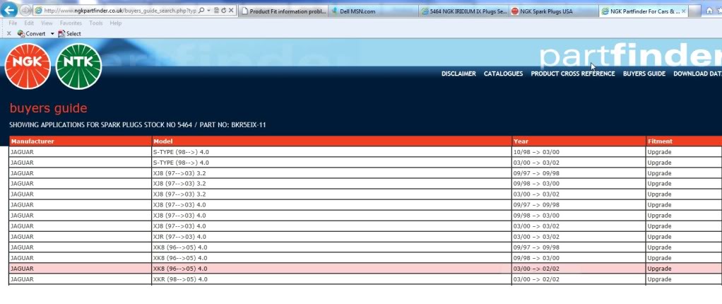

UPDATE - I received an email reply from NGK tecnical that confirms that the NGK 5464 is a suitable replacement plug for 2001 XJ8
Look at post# 21 in the thread: https://www.jaguarforums.com/forum/x...baffled-73022/
I disagree with Advance Auto Parts see my response in the other thread (post# 22) Also I opened a new case issue with Advance Auto Parts Content Department about the Product Fit information for the NGK 5464 spark plug - It will take them about another 2 weeks to address the issue:
https://www.jaguarforums.com/forum/x...83/#post514378
I really do not belive your misfire issue is the NGK 5464 spark plug. The misfire problem might be oil fouled plugs.
The engine in the Vanden Plas 4.0L is not different than the engine in the XJ8 4.0L.
Here is another NGK spark plug Buyer's Guide on the NGK website - this one is SHOWING APPLICATIONS FOR SPARK PLUGS STOCK NO 5464 / PART NO: BKR5EIX-11
Look at the Chart - XJ8 4.0L Upgrade - Model Years Groups it fits 09/97 - 09/98; 09/98 - 03/00; 03/00 - 03/02; XJR 4.0L Upgrade 03/00 - 03/02
Also S-Type 4.0L 10/98 -03/02 and some of the XK8/XKR 4.0L - no sure why the XJ8 3.2L is on the chart for 03/00 - 03/02
