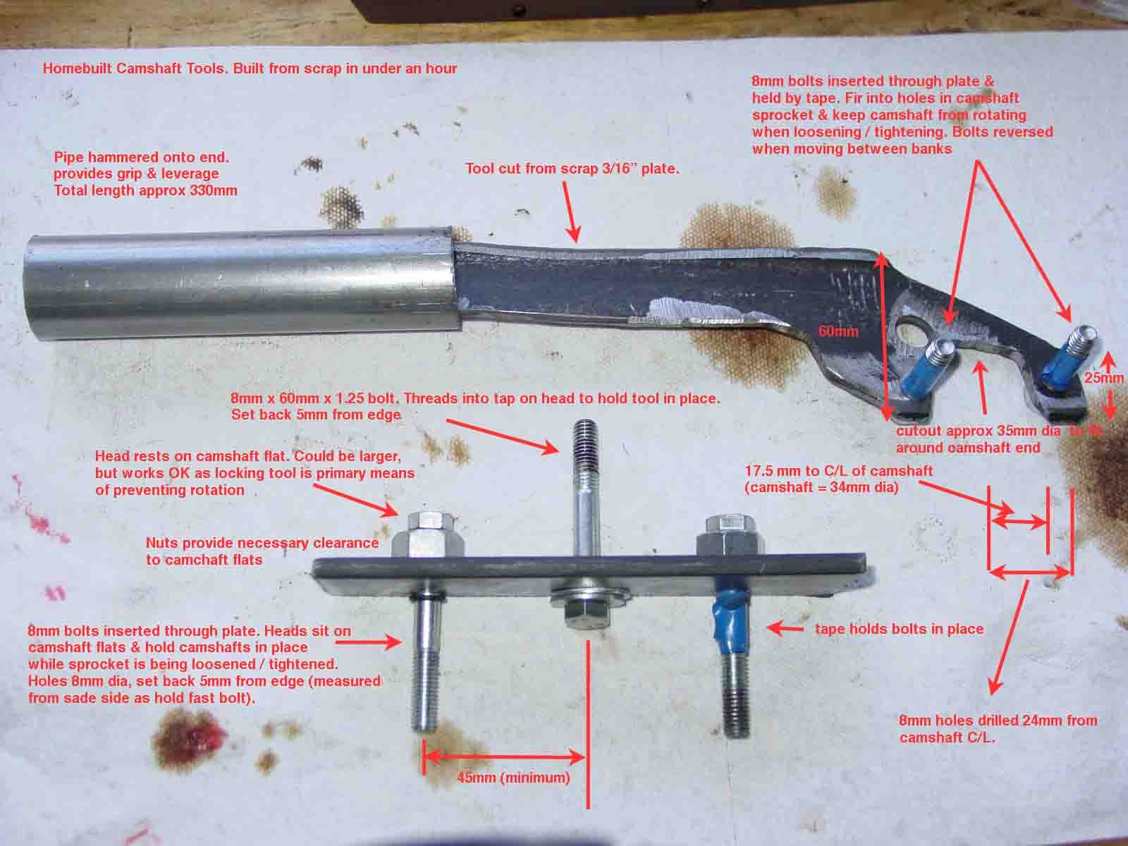

Saw this forum item was still bubbling along and thought I would repost the photo of the tools I made for the job I did on my car in 2006 for those who want to save a few bucks on the tools. Easy to make & worked just fine.
I also have a copy of the write-up on the job I sent many other forum members when I did the job if anyone is interested (although it seems that there is lots of info on the forum since I wrote it that parallels it, so it is mostly redundant)
