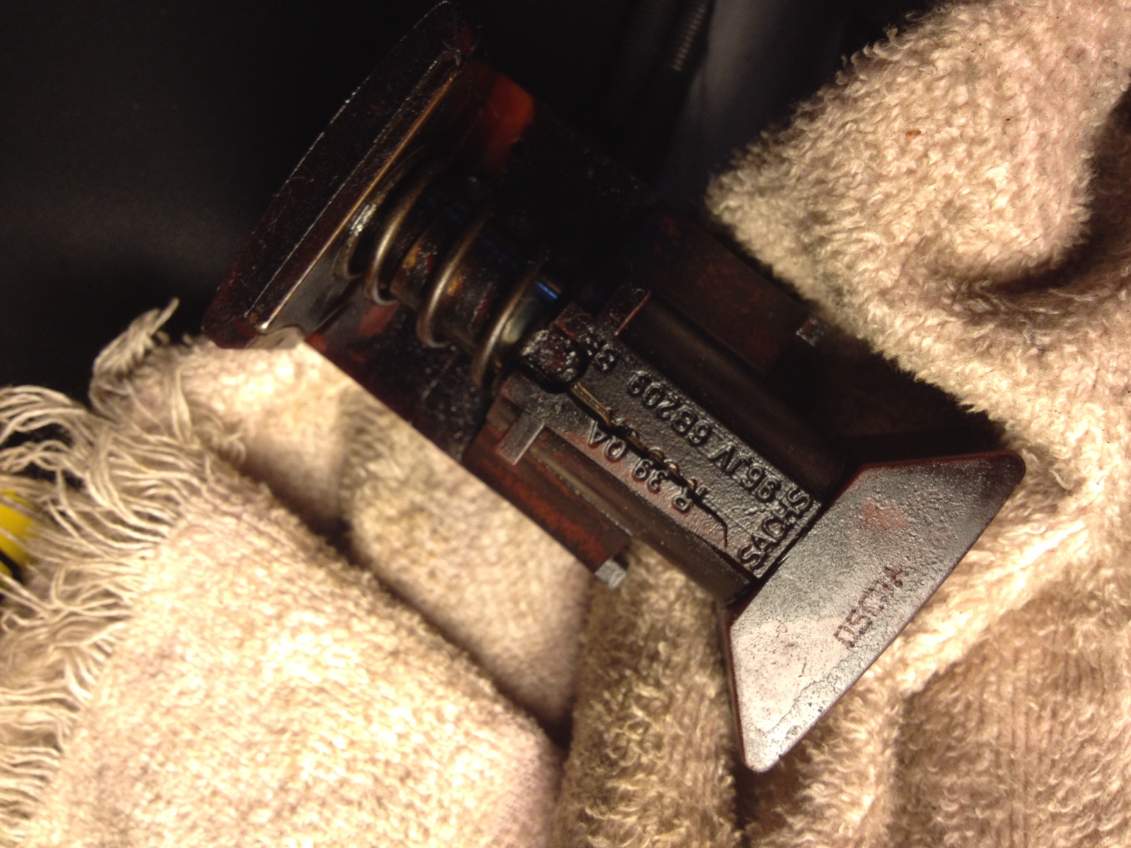

From: Virginia
Default old tensioner
By the way, is this bad?
Attached Thumbnails I just changed my own timing chain tensioners........HOW TO-img_1919.jpg
Old Apr 11, 2015 | 08:44 PM
  #285
test point's Avatar
Posts: 5,390
Likes: 1,116
From: Ellijay
Yes, that is BAD!

Default Passenger side tensioner
I think the other may even be worse. The guy who sold the car to me said he didn't think the tensioners needed replacing. haha
Attached Thumbnails I just changed my own timing chain tensioners........HOW TO-other.jpg
In the photo, am I seeing a large portion of the rectangular housing to the left side missing? Is the plunger supposed to be covered? If so, Where did the missing part end up?
Old Apr 12, 2015 | 11:02 AM
  #288
JWT's Avatar
JWT
Posts: 207
Likes: 41
From: Calgary Alberta Canada
The missing bits will be in the bottom of your crankcase and possibly caught up in the oil pickup screen.
If you drain the oil and take off the bottom crankcase cover, you can likely retrieve most, if not all of it.
The pickup screen is held on by a couple of bolts and comes off very easily. There may be bits caught up in the ridge around the perimeter if I recall correctly. Taking the pickup off to have a god look and clean it properly is a 10 minute job.
I cleaned mine out and found quite a bit of plastic rubbish in there. You can likely remove the pan without needing a new gasket, as it is a not paper or composite gasket. Just consult the manual for tightening sequence and torque settings. (it is a pretty low torque setting so if you don't get the actual number, don't go overboard on tightening) Sorry, I don't have it readily accessible right now.
Are you just doing the secondary tensioners?
Good luck

Default New tensioners in place
Hello again,
I finished the work last night at about 1am, just putting on secondary tensioners. My work schedule simply won't allow me the time to replace the whole timing setup for some time. Since my wife just got the car, she really wants to drive it, so I at least did the secondary tensioners so I could have more peace of mind about her tooling around in her new Jag for the next couple of months. Maybe as a late Summer project I'll replace the rest of the timing components.
I NEVER found anything about the cam cap torque ratings. No one responded and I searched extensively online and found nothing. I probably over torqued them, but I needed to put the car back together. They are torqued somewhere between 22 and 27 ft. pounds but I did them that tight because they were remarkably difficult to loosen when I took them off. I hope there will be no future problems.
Engine runs very nice, timing seems perfect and engine seems to "purr" a little better (that could be my imagination since I'm envisioning those shiny aluminum tensioners in there now). I'm going to changer the oil on Tuesday, but it didn't appear to me that there were any missing parts to that tensioner; are you guys sure? I had no intention of dropping the oil pan.
Thanks
Jeff

Default no missing plastic
As I said, the tensioners were in rough shape but appeared to be intact. I don't perceive there to be any plastic junk. Are you referring to plastic bits from elsewhere in the timing system that may have come loose?
Old Apr 13, 2015 | 12:00 AM
  #292
JimmyL's Avatar
Joined: Oct 2008
Posts: 1,834
Likes: 453
From: Virginia Beach, VA
I don't see any pieces missing. You may be okay. Mine looked about the same when I replaced them. Maybe I'm missing something. You're probably okay on the cam saddles. I'm not sure what the torque is, but somewhere around 25 ft lbs should be good. But letting your wife drive it ? I don't know ... ;^)
Oh wait, the second picture looks a lot worse. Some plastic missing there ?
Old Apr 13, 2015 | 12:33 AM
  #293
harvest14's Avatar
Joined: Apr 2015
Posts: 1,386
Likes: 370
From: Virginia
The tensioner in the second picture came apart when I pulled it out, but it all appears to be there. Thanks for the response, especially about the cam cap bolts.
