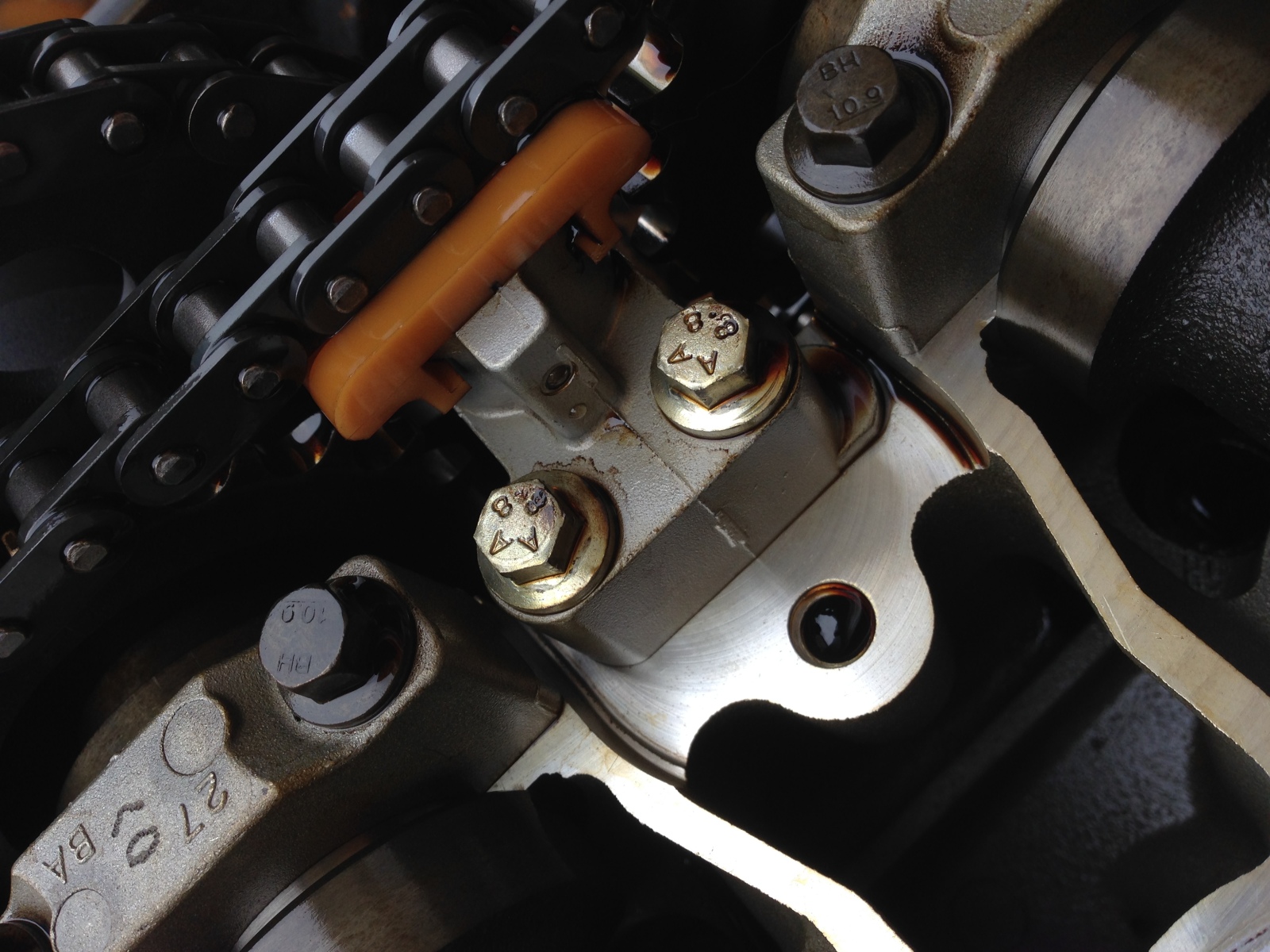

Does this look like the updated tensioner? Took the risk and purchased a 99 XJR wrecked for whatever reason and I opened the valve cover and found the tensioners weren't plastic, but metal/aluminum looking.
Attached Thumbnails I just changed my own timing chain tensioners........HOW TO-123mclg.jpg
Old Mar 4, 2014 | 05:18 AM
  #205
test point's Avatar
Posts: 5,390
Likes: 1,116
From: Ellijay
Yes, that is the metal tensioner.
