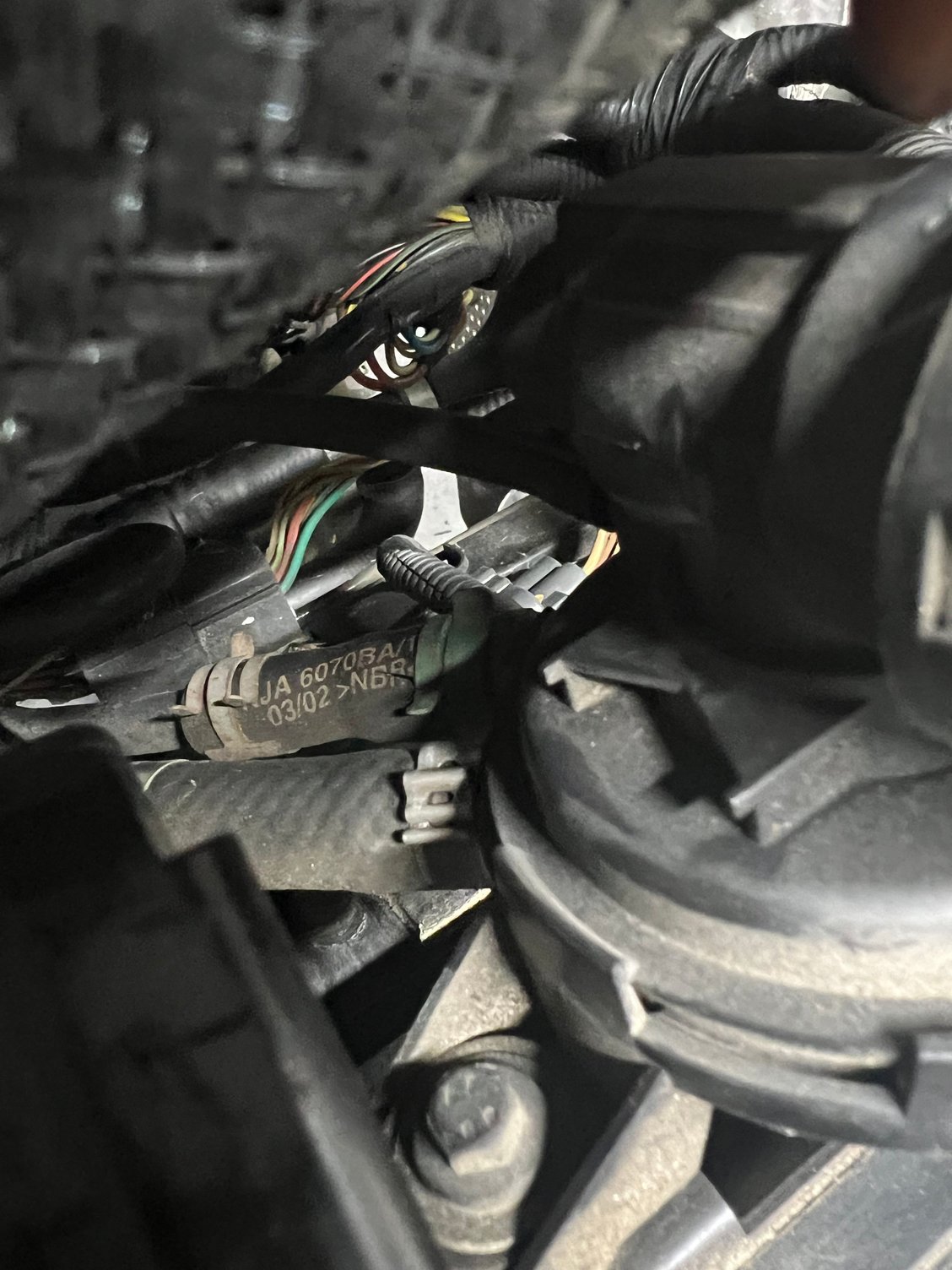

2003 XJR. After put tank back had P0121 for the first time ever with fail safe warning. Decided to clean throttle body connections with electronic cleaner and add some dialectic grease. Spotted this unconnected vacuum hose. Can’t find where goes.

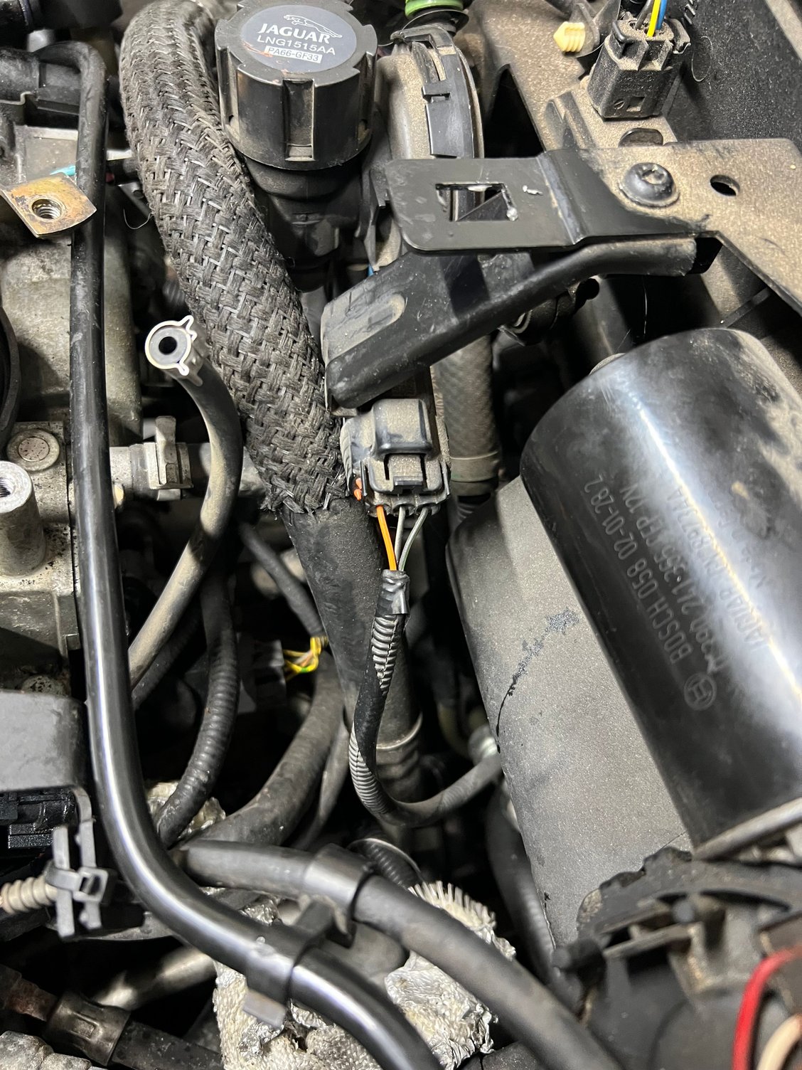

You mean EVAP. 2003 XJR does not have EGR. Pic below shows 1 thin line and 2 thick lines going into EVAP.

Pic shows where vacuum line comes out under throttle body.

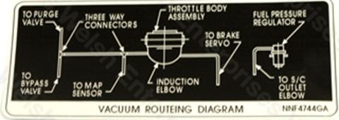

Hmmm, have you checked the driver side of the throttle body or a "T" junction back there? This is a replacement sticker from Welsh, I tried blowing it up without distorting it too much.
Other than that, I defer to Addicted or Bob to chime in.

Default Figured it out
MAP sensor. Thanks for the diagram.

If you don't have that diagram sticker up by your radiator, here's the link... https://www.welshent.com/Search?k=nnf4744ga
