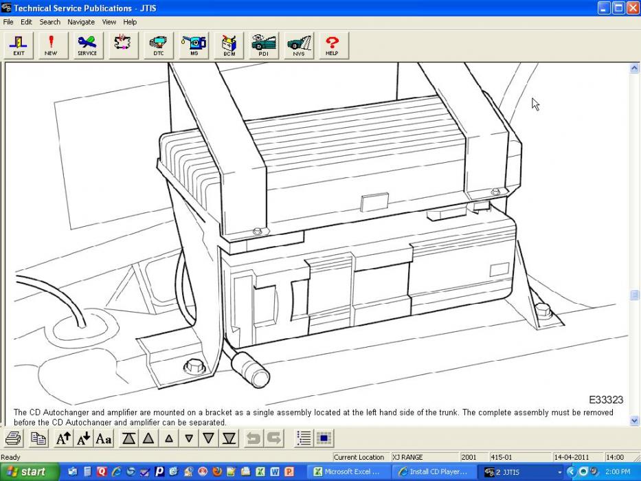

Hi SirJag
Here is a jpeg file I created from 415.01 section of the JTIS 21 cd - for 2001 XJ models - premium sound system. Shows both units with bracket holding the Amp & Autochanger together and installed in the boot. The Amp is mounted on top of Autochanger.
Install CD Player & Amp from 2003 XJ8 into 2001 VDP?-2001-xj-cd-autochanger-amp-diagram.jpg

Hi SirJag
I just checked our unit in the boot.
You need to bolt the Amp to the top of the autochanger and then attach the mounting bracket.
And yes there is enough room behind the side liner (the amp & autochanger are not that tall).
The boot side liner needs to be removed (driver side ) where you see the access whole for autochanger.
You need to remove the plastic access panel for the driver side stop and signal light. Then you can remove the side liner by pulling the top down slightly and towards you. You also need pull down a small section of the ajoining back side liner (they are interconnected).
Jim Lombardi

Hey Jim,
I took a few mins today to look at that trunk opening. It looks empty, right? Well, you were right on the money. I pulled back the carpeting/liner on the side and behold... the amp was sitting there! So, looks like I'm only missing the CD player & magazine. There is a cable with connector just sitting there, obviously for the CD player. I need to look closer, but I assume the CD player affixes to the same mount that the amp is on.
SirJag
