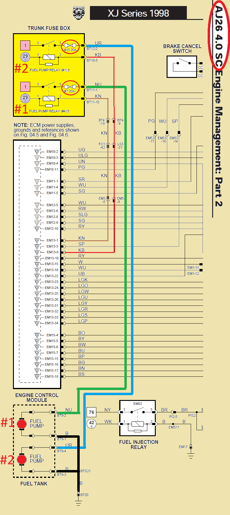

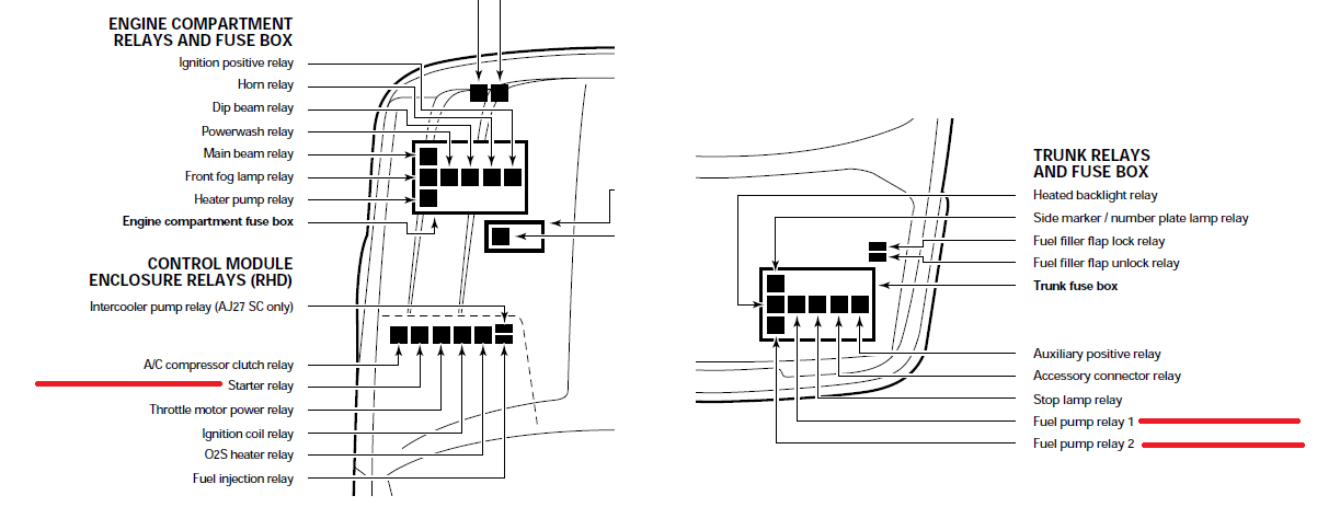

Hi lady penelope thanks 4 you reply so i will test this in the morning.also were is the fuel relay.thanks
Old Jan 21, 2018 | 01:47 PM
Lady Penelope's Avatar
Joined: Apr 2017
Posts: 4,039
Likes: 1,397
From: Kansas City USA
If you have the S/C engine you will also have # 2
Attached Thumbnails Jaguar xj8 4.0 2001  starting problem from cold-x308-fuel-pumps-ntitled.png   Jaguar xj8 4.0 2001  starting problem from cold-x308-no-start.png
