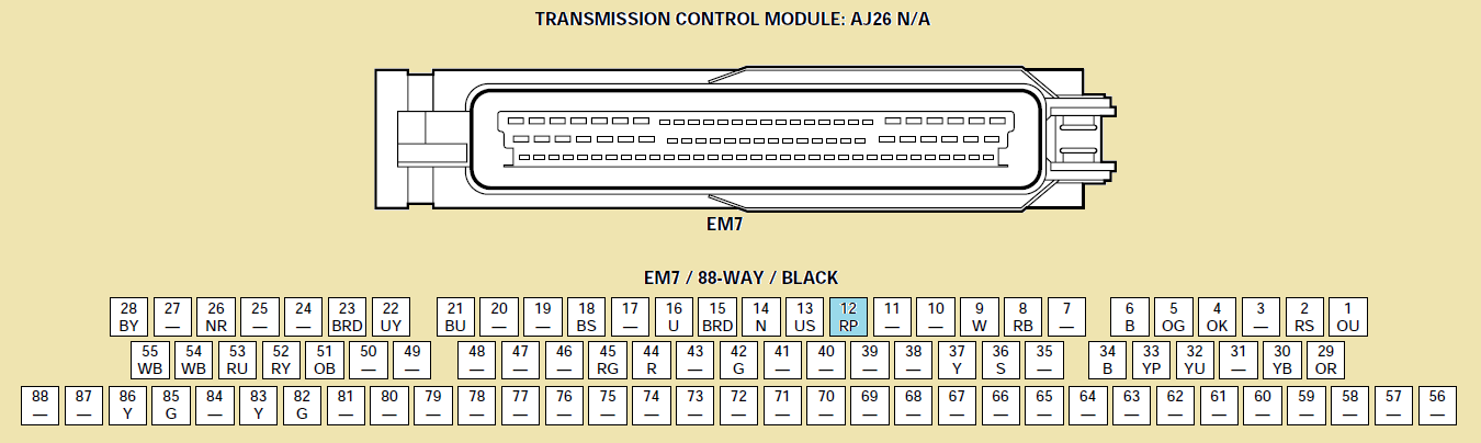

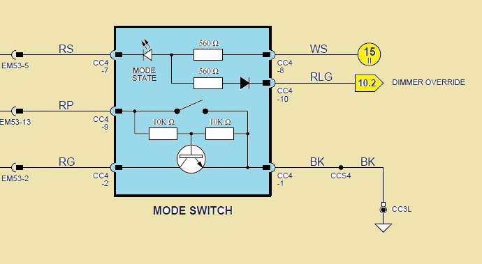

On the N/S switch did you get the mode light ?
If not check the switch by looking for a ground at the transmission connector car direction pin 12 ( Red / Purple wire ) as you cycle the switch .
Attached Thumbnails just bought my first jaguar! (gearbox fault?)-x308-transmission-aj26-untitled.png   just bought my first jaguar! (gearbox fault?)-x308-mode-untitled.png

Yes , test the switch with a meter at the transmission connector . The light verifies that the transmission has switched as a follow up through the transmission . The meter will go from 0 to 20 ohms as you switch it from S to N . The ground may have been disturbed .

I don't have the X308 but mine is under the dash on the passenger side very bottom , very fwd . The Red / Purple wire is not a ground but a point to point wire that you would use to read through to switch to the ground coming out of the switch . This keeps you from removing the switch however hard that would be .

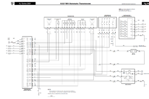

From that same transmission connector you can read all the shift solenoids as they should read the same resistance . If you have to replace a solenoid it's easy just drop the pan and plug and play .
Attached Thumbnails just bought my first jaguar! (gearbox fault?)-x308-2001-transmission-ecu-untitled.png   just bought my first jaguar! (gearbox fault?)-x308-2001-transmission-untitled.png
