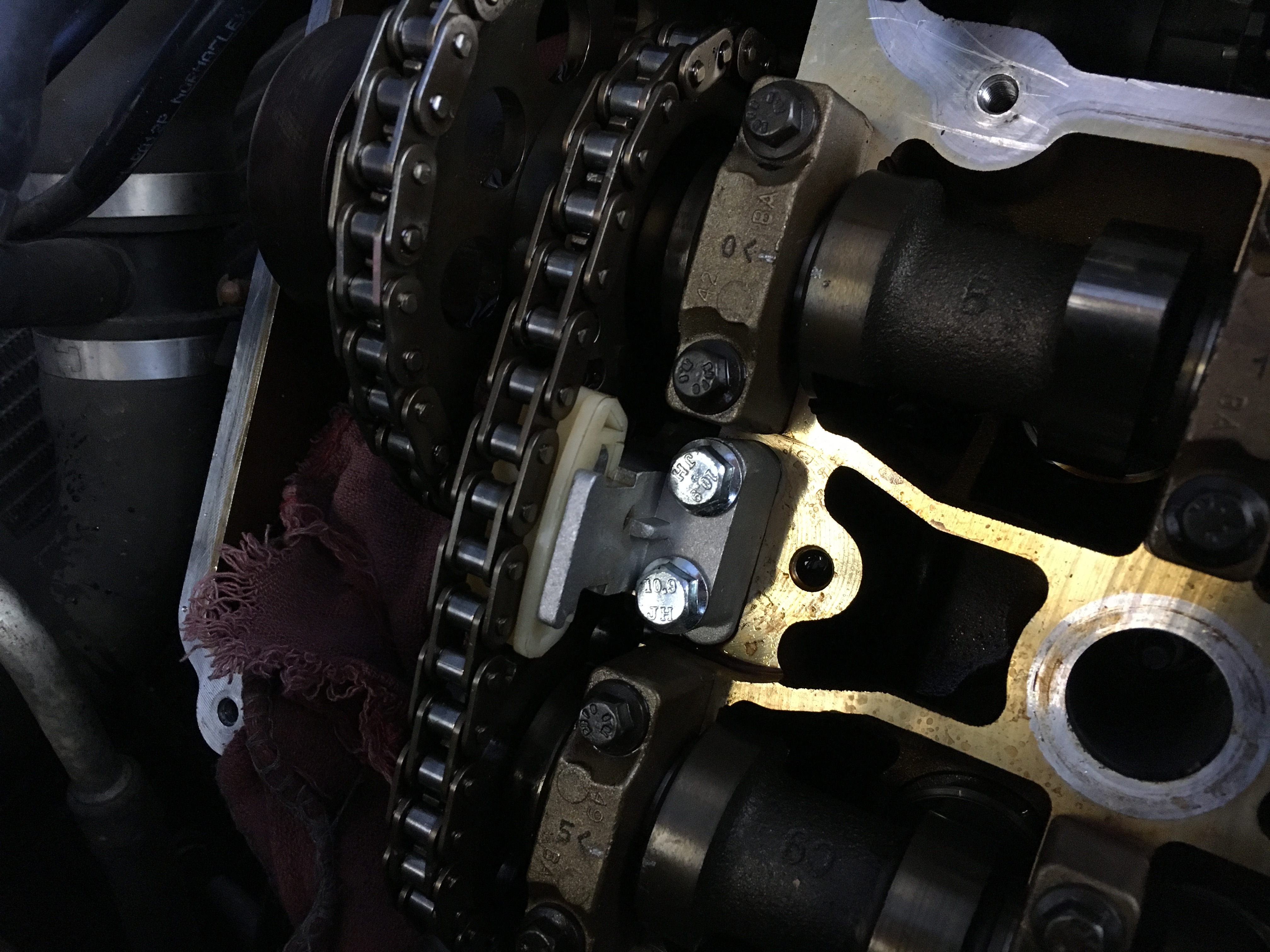

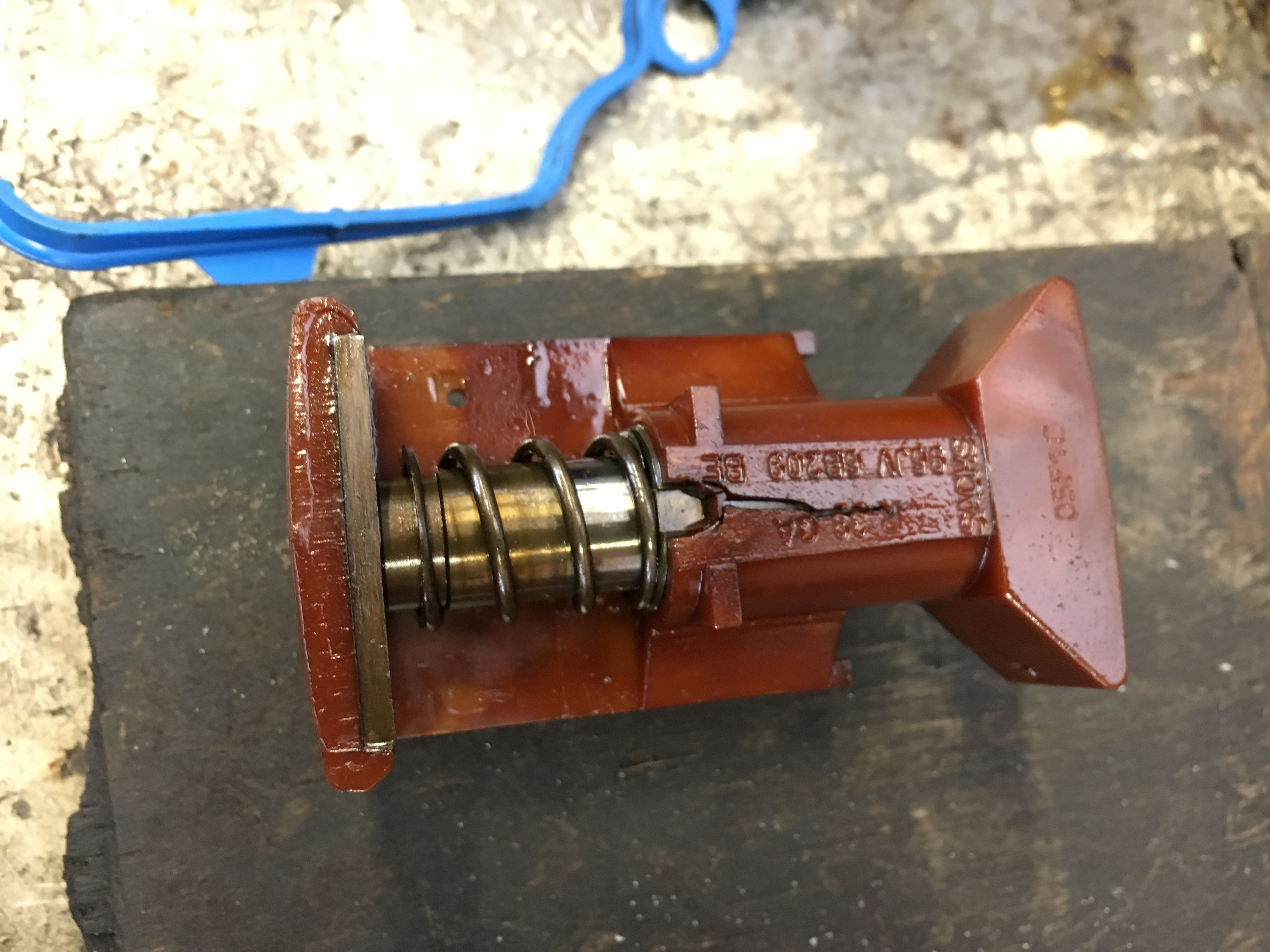

I just got this XJR last week, it has a August 2001 build and I can't find the engine serial no. So I just decided to but a new metal tensioner thinking it still had the 2nd gen plastic ones and voila! See the first picture, the tensioner is plastic and has crack, trouble waiting to happen. My Jag has 83k miles only. Second pic shows newly installed metal tensioner.

For some reasons I can't attach the second pic so I'll just add it here

Proper preemptive strike, kudos.

Good job, none too soon!

Good work!

Still strange how different things can be.
Did mine last week, and the plastic tensioners came out without a single crack.
almost 70.000 mls. on them.
Still happy that I did those, it feels much better.

I'm thinking local climate accounts for a lot.
2nd gen added the spring, but it only made it rattle less before it failed.
Nice save!

Did you place all of them or are you still happy playing engine damage lottery?
Nice save!
Vector
And the spring stopped giving us an audible warning of it's impending failure, poor decision on jaguars part.
Now here's the passenger side secondary tensioner, see how the plastic has been taken off the metal piece. How the chain has practically sawed the metal part, yet before I opened the valve cover I never heard any metal to metal grind. I have saved a Jaguar from catastrophic failure, feels good to catch this in time.
Now you need to ask "where did that plastic go?"
In the oil pan.

Lucky the plastic slipper didn't lodge between the exhaust cam gear and chain and snap it- very common.
