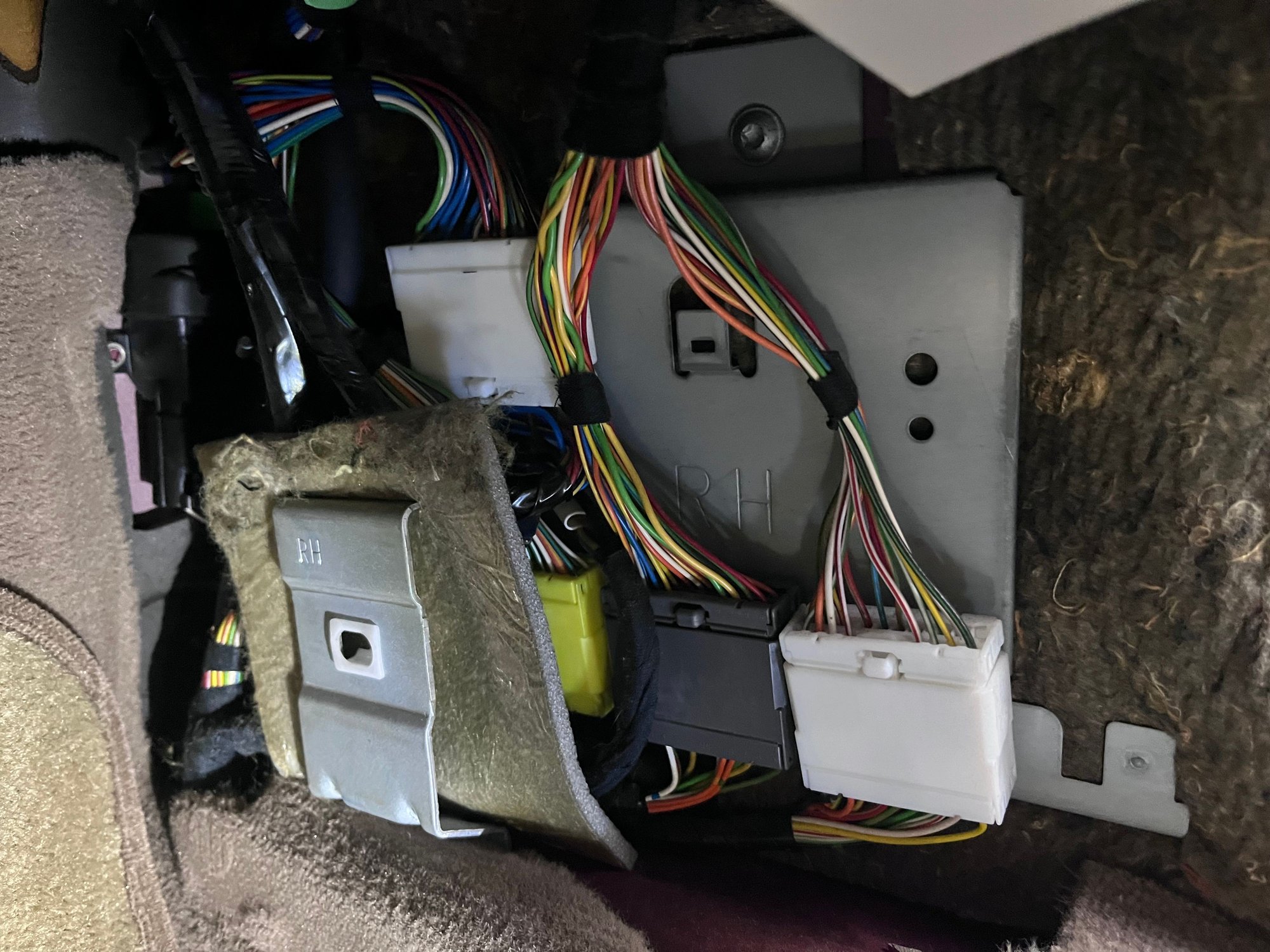

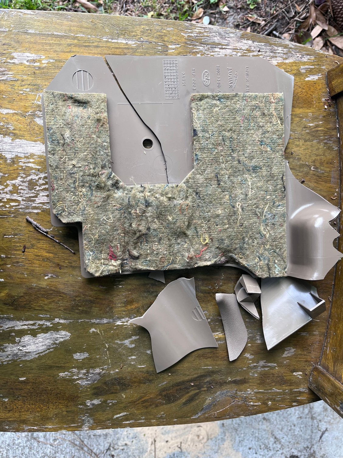

My fellow X308 enthusiasts. I am getting discouraged. The HVAC unit under the glovebox leaks water into my passenger footwell carpet. I suspect a clogged rubber drain hose. I went in search under the car- couldn’t see it. I looked at some photos online and tore out my passenger footwell right side kick panel. It crumbled in my hands like a potato chip. And- no sign of a drain hose. Can someone please tell me exactly where the A/C drainage hose tube is located?
And now I need an intact Sable colored plastic kick panel as well…
Thank you all.
Jaguar kick panel made by the Lays Potato Chip company
No sign of the rubber drain hose

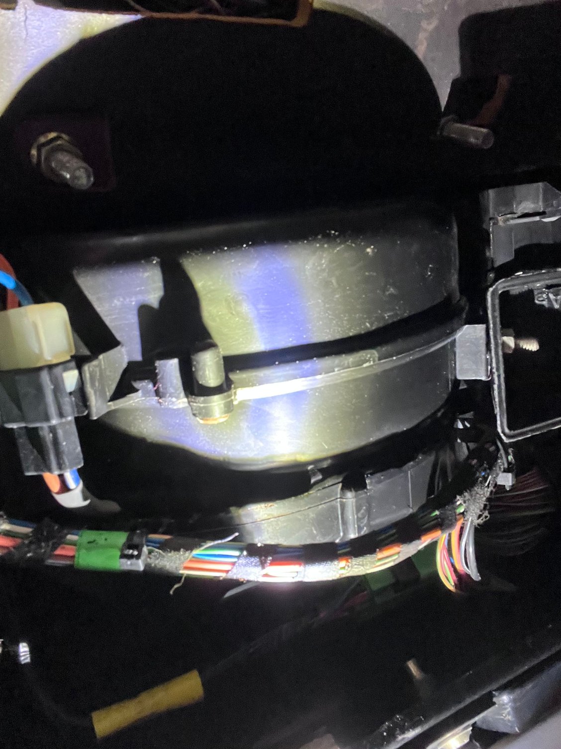

A/C unit from whence the drip emanates

Default Still dripping…
I pulled back the carpet on the transmission tunnel and removed and checked both rubber A/C drain tubes and both were free of obstruction. And what a delight to twist the grommet of the tube back onto the transmission tunnel. Silicone grease helped.
Are there any other drainage tubes or areas I should check for clogs? Are there places under the wiper blade fascia that runs along the base of the windshield?
what is causing the condensation to collect and drip onto my passenger footwell carpet?
