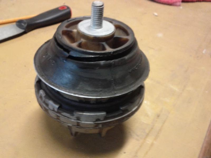

While doing an oil change I saw the cat was weeping purple fluid.
Looking further, it seemed it was coming from the RH engine mount.
I pulled it out after removing the lower T30? bolt on the bottom and the 15 mm nut on top. I had to jack up the engine 1-2" but it came out.
Got a replacement from my local Jag dealer as many seemed to report that the aftermarket URO shock mounts even though it was twice the price $130 vs $68.
Only took about 40 mins out and in for the left hand side. The right looks harder, but I guess the left take a lot of the load under acceleration.
All the liquid leaked out
