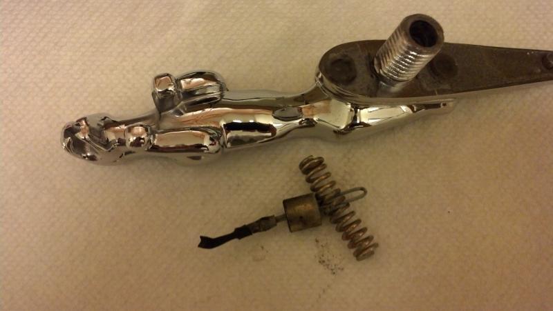

I understand. I bet some type of double sided tape would work. As long as you carefully cut it to not go past the edge of the base. I’d stop 1/8” from the edge. Probably many types of adhesive would work & hold the base firmly. The trick is finding one that will not damage your hood & that you can remove relatively easily if you need to replace the leaper again.
It’s curious that someone cut the leaper cable & replaced it with that “Rube Goldberg” makeshift mechanism. As I understand, the purpose of the spring loaded cable is to minimize or eliminate damage to the hood when vandals/thieves rip off or attempt to rip off the leaper. I doubt it is to allow us to rotate our leapers so they face the windshield. Who would do that, it looks stupid. Theft of leapers & other hood ornaments is all too common.
BTW, how did this mysterious someone attach the wire to the leaper after they cut the cable? I think there is a hole on the bottom of the leaper bc when I removed my broken one (cable & spring fell out) even though the cat is still mysteriously attached to the base, I can look into the threaded tube & think I see a ‘c’ shaped ring that s/b an ‘O’ shaped ring where the cable used to be attached. The open/broken part of the ‘c’ is facing down the tube. When my cable fell out the cable loop was intact. I suspect for most leapers, this would cause the cat to fall off the base. I will attach a photo of my old leaper, just removed.

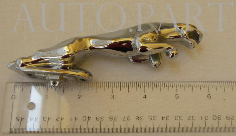

I found a photo on eBay of a leaper w/o a base. I wonder if this is stolen?
I’ve seen other photos of leapers w/o bases with the cable still attached. Seems like that would happen when the thief/vandal pulls hard.
Anyway that open ring on the bottom is clearly broken in mine which explains how the cable fell out with the loop intact. Now whether it just broke after 7 years or someone pulled it.... is a mystery.
Normally after a theft, the leaper would be gone leaving just the base but, as I’ve stated, for an unknown reason, my leaper remains loosely attached to the base w/o a cable or a spring.
