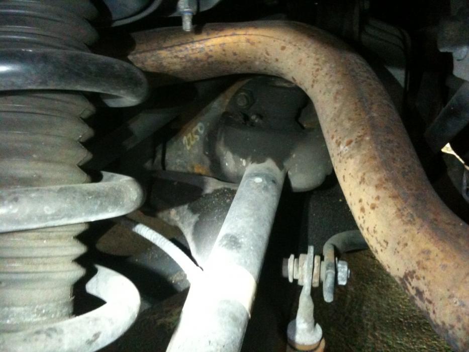

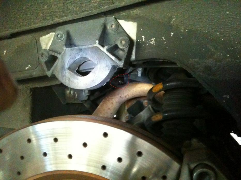

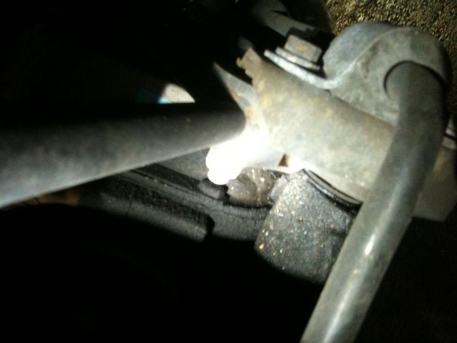

also i checked my differnetial breather, took it out and it was in mint condition, so i clogged breather is not my problem...i also took more pics of the area and i am wondering if maybe i dont' have a leak and maybe just the last time it was filled someone made a mess...see all the pics and let me know the assessment, i also attachwed a pic with a red circle around the breather so any of you who want to check it can see where it is...it is hard to get to and i had to extend my arm all the way under and contort it to get to the breather...worked ok...took about 15 mins to take it out look at it and put it back in...
Attached Thumbnails left output shaft replacement? or just a seal?-photo-4-.jpg   left output shaft replacement? or just a seal?-photo-5-.jpg   left output shaft replacement? or just a seal?-photo-6-.jpg   left output shaft replacement? or just a seal?-photo-2-.jpg   left output shaft replacement? or just a seal?-photo-3-.jpg

How do you *know* the breather is not clogged. The originals have a rubber spring loaded disc intended to act as a one way valve. Did you blow through it?
Picture number 5, what orientation is that? There is are two visible cracks. Maybe that is the source of your leak. Especially if the staining is downwind/below the dirtier larger crack.
If you think that the mess is from sloppiness, refill the diff since it may be low anyways. Clean off the diff. Check the diff level and diff cleanliness in a week or two.

hey plumsauce...i was able to blow through the breather no problem...i don't think that is a crack in pic 5...the picture is sideways and taken from the driver side wheel well...i like the idea about filling the diff, i think i am going to start there...i did try cleaning up the grease, but it is pretty baked in there, with lots of dirt...i am hoping my mechanic can double check it in the new week or so...
