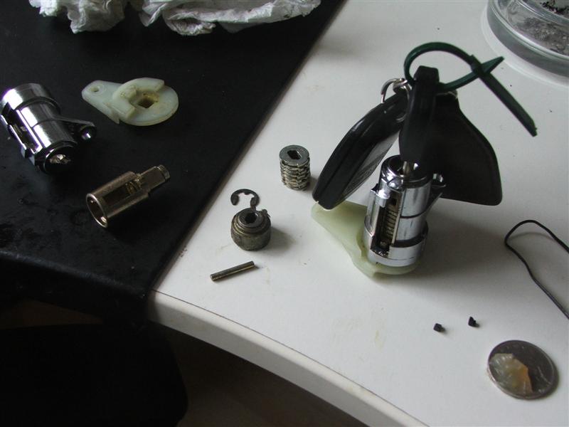

If the point is - the key opens the boot, it should open the door lock it's a simple thing to refurbish, but not as simple to get to - the door card needs to come off then you've access to the lock. I've swapped all locks on mine with a new lock&key set and even swapped a left hand drive lock into the rhd handle, that's something I wouldn't recommend with a hangover (the new keys needed factory programming)
Great to hear your back into the car - fobs generally pop up on ebay for around £30-40 and a refurb service for around £20 (new buttons and micro switches) I can send you a dead one to get refurbed, I've a couple kicking around...
