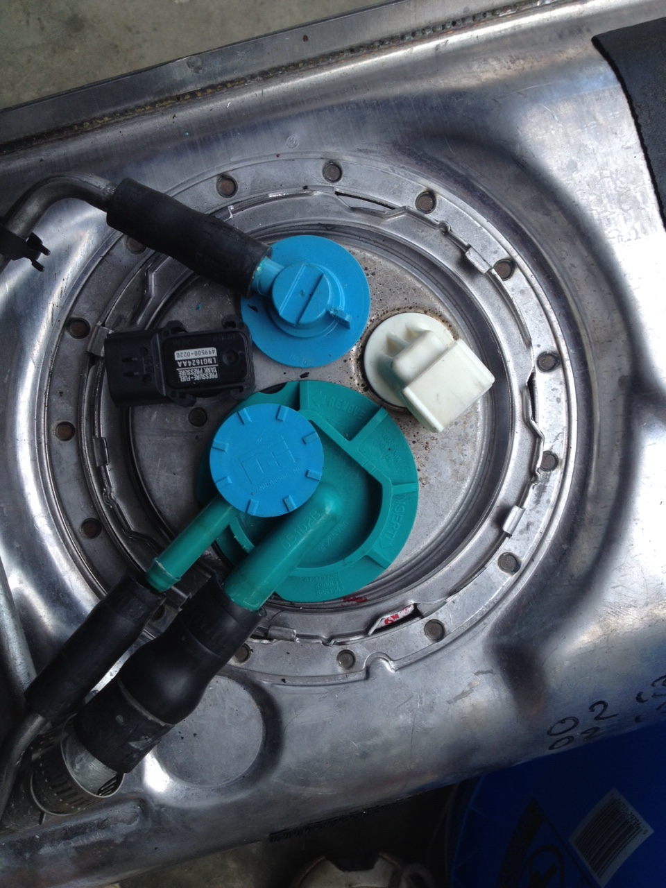

I got the fuel tank out! The stressing over disconnecting those two lines underneath the last few days was worse than actually doing it. Once I figured a way to get my hands in there, they both came out fairly easily. I did have to loosen the parking brake cable (hope I don't regret that later). I marked exactly where it was tensioned to.
Now I am going to check out the pumps and leads inside.

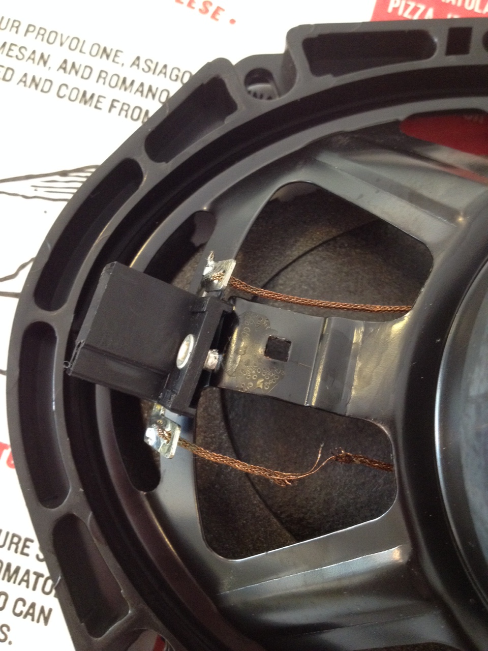

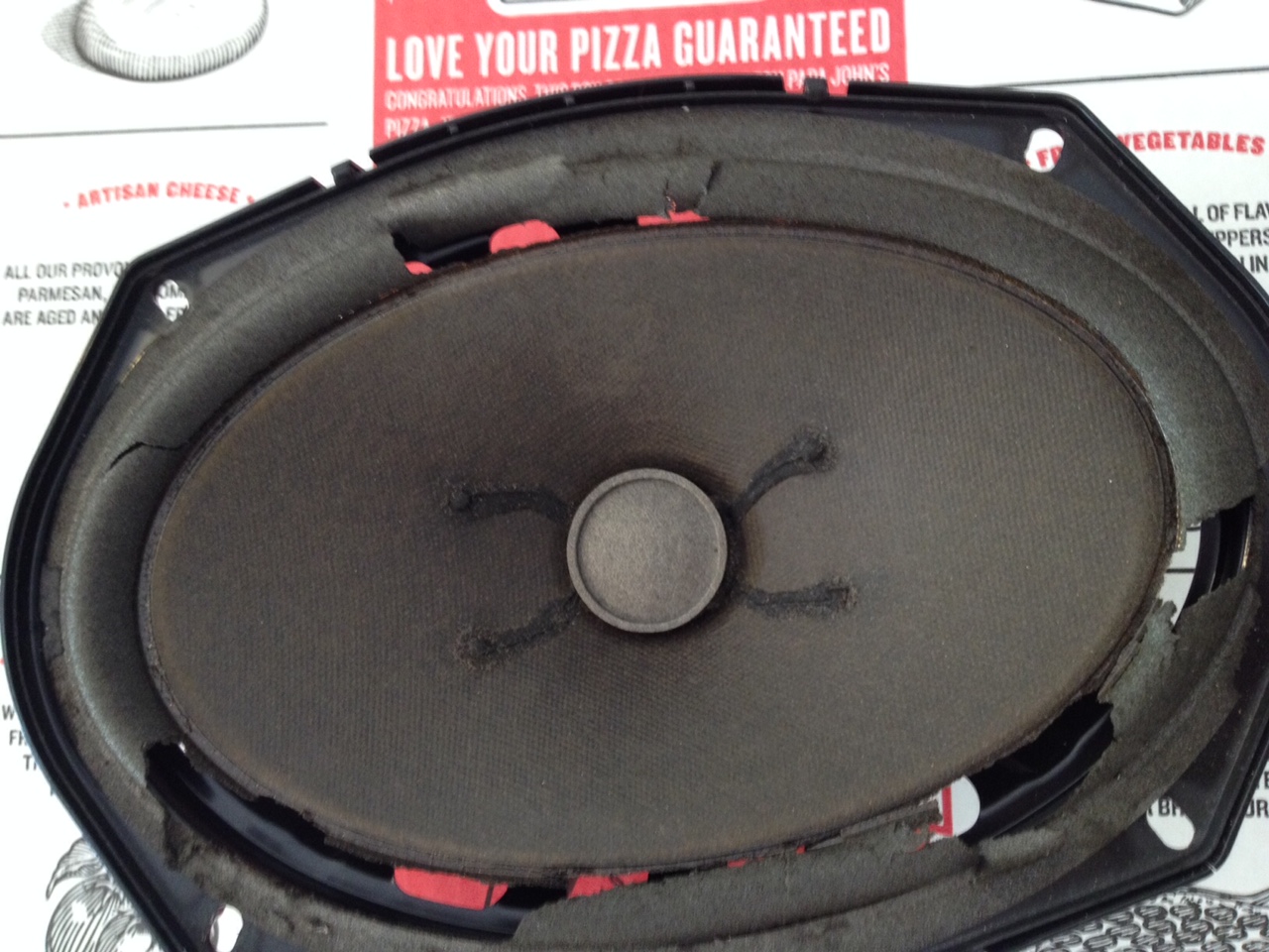

I also decided to take apart the rear seats and remove my non-functioning subwoofer while I was working on the car today. The speaker that came out definitely needs new foam (which I already have from Speakerworks) but one of the connection points is also badly damaged. I would love to find a reasonably priced new speaker or good condition used one and just replace it. Please see pictures below.
Now.... how the heck do you get the three little hoses off so you can unscrew it? There is no room to slide them off. Unbelievable that I would get this far and get stumped by THIS. lol I am at an impasse...
-- Seriously. I just added a picture. It took me 10, maybe 15 minutes to disconnect the dreaded fuel connections above the differential. But, an hour and 15 minutes later I have ONE of the three hoses off. Someone please tell me there's a trick to it and that someone didn't intentionally engineer it this way. JTIS is no help...

I managed to get two of them off; had to cut the other one. Even when it was cut, getting the pieces off was unbelievably hard! I have never seen a rubber hose so shrunk onto a fitting before. I am amazed nothing broke in the process. Now I have to break my stride and go to the auto parts store for a piece of fuel line.
One of the link leads is integrated with the wires from the fuel level sending unit. Replacing that link lead, if I even had a new one, would be difficult. The fuel level gauge works fine and the ends of the lead look clean and shiny. The wires show no damage either. The other link lead (don't know which pump is primary and which one is secondary) also looks good. Shiny connection points and no damage or discoloration on the wires.
The Airtex pumps are pretty much exactly the same size. The upper rubber mounting piece is a tighter fit, but it wedged up high enough that the pump feels secure in the bracket. None of the items that came with the pump were necessary, except the adapter wire of course. I re-used the bracket and both rubber pieces from the Jaguar pump, which according to the date stamped on the pumps were original (Feb 13, 2002).
I siphoned until the tank had only a few ounces left. It looked very clean inside. I wiped with a clean shop rag where I could reach, but it was shiny and spotless inside. I can only see the middle section as there are partitions separating each outer third of the tank, presumably to prevent sloshing around during spirited driving. I'm not planning to clean any further. The gauge showed just a hair above empty when I pulled into the garage; I'd say I got another 2 and 1/4 gallons out with the siphon. I will pour that gas back in when I'm done and drive to the gas station.
There is not a seal in the Airtex kit that matches the one on this tank. There is an O-ring about the same size, but the seal in place is flat. It looks perfectly soft and pliable, so I will re-use it.
