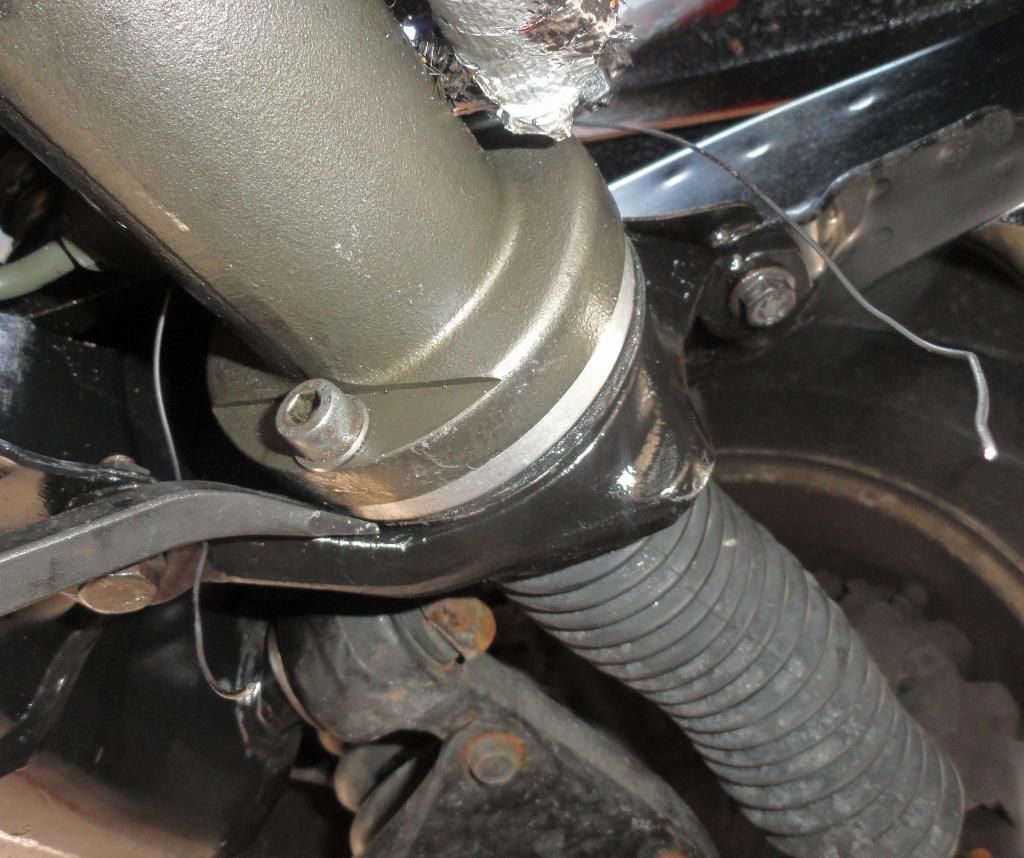

This pertains to the X300 which is similar . There are shims that can be inserted into the gap between the lower steering assembly and the cars mounting brackets without removing the steering gear . SPC1059 may be the number . This removes the walking of the steering . There is a technical term for this .
Attached Thumbnails Lower steering column recall?-80_rleveringspacerinfeedingwirearound_80c759d877a9a0aa394d65380102dc86c4301a72_b20ec33dd7101a730.jpg   Lower steering column recall?-jaguar-spc1059-1-.jpg

That looks like a steering rack from an X300. Which isn't the same as that from an X308. I have new rack mounts. The issue is definately now BEFORE the rack aka in the column I can still feel play in the column...
But thanks for the idea... Though it unfortunately won't fit the X308.
