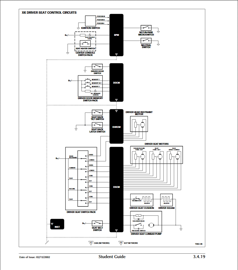

My driver's seat lumbar support stays up. I push the button to turn it down, as soon as I release the button it automatically goes up again.
Can someone help with this by either disconnecting JUST the lumber support or tell me how to fix it? I don't want to pull the fuse as it stops the whole seat moving.

This is the best I can get you, you'll have to trace out the wire. Sounds like you have a short on the activation.

Thank you very much for the diagram. Will get back to you with what I find.
