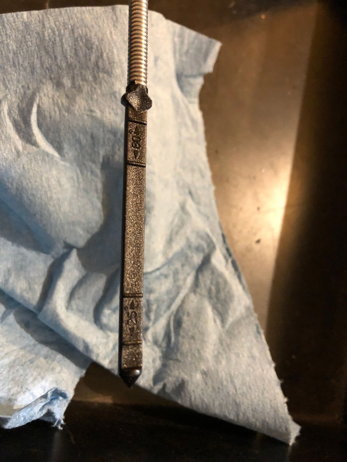

Today I marked the dipstick at 704mm to make sure I fully inserted it. It did not seem to go all the way down until I jiggled it and pushed a bit harder. I started the car, shifted through the gears with the brake on, then checked the fluid level with the engine running and the dipstick now fully inserted. I considered the fluid to be “cold” at this point, so it should be between the two lower marks in the 25 degree range (see pic of the dipstick). It was much, much fuller than that, clear up in the 80 degree band. I am now prepared to believe that I had not been fully inserting the dipstick, unbeknownst to me, and that I’ve been overfilling the transmission ever since I first checked it. Yikes.
My question now: Here is a picture of the dipstick. How much capacity is represented by the gap between 25 degrees and 80 degrees? I’m trying to determine how much fluid to drain out. I mean, you gotta be kidding me if this has been the problem the entire time......
The only way is to drain some out (say, half a litre) and check the level again. Then, either drain more or put some back. Be prepared for a number of "iterations". As you will have a number of engine starts/stops, the ATF may warm-up a bit in the process so, perhaps, when you finally reach the level around the 25C range, make a judgement as to how much higher the ATF temp is (touch the sump by hand) and set the level a few mm above the upper 25C mark. You can then, the next day, have another go when the ATF is at your ambient temperature.
