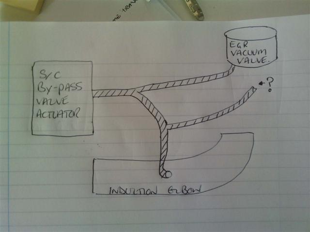

My map sensor cel has gone off and I've looked into it and it seems like its usually a disconected vacuum hose, I think I've found the map sensor (near the wiper motor) but I can't seem to find the vacuum hose, are there any diagrams you guys know of that can help?

Hope this helps, had this happen when swapping superchargers last year.
First pic is of the loose vac tube with the zip tie, not connected.
The question mark tube is to the MAP sensor.

hey...this happened to me, and i bent the mount that the MAP was connected to give it more slack and it worked fine...my mechanic did discnnect it and some it lost some slack in the process...
