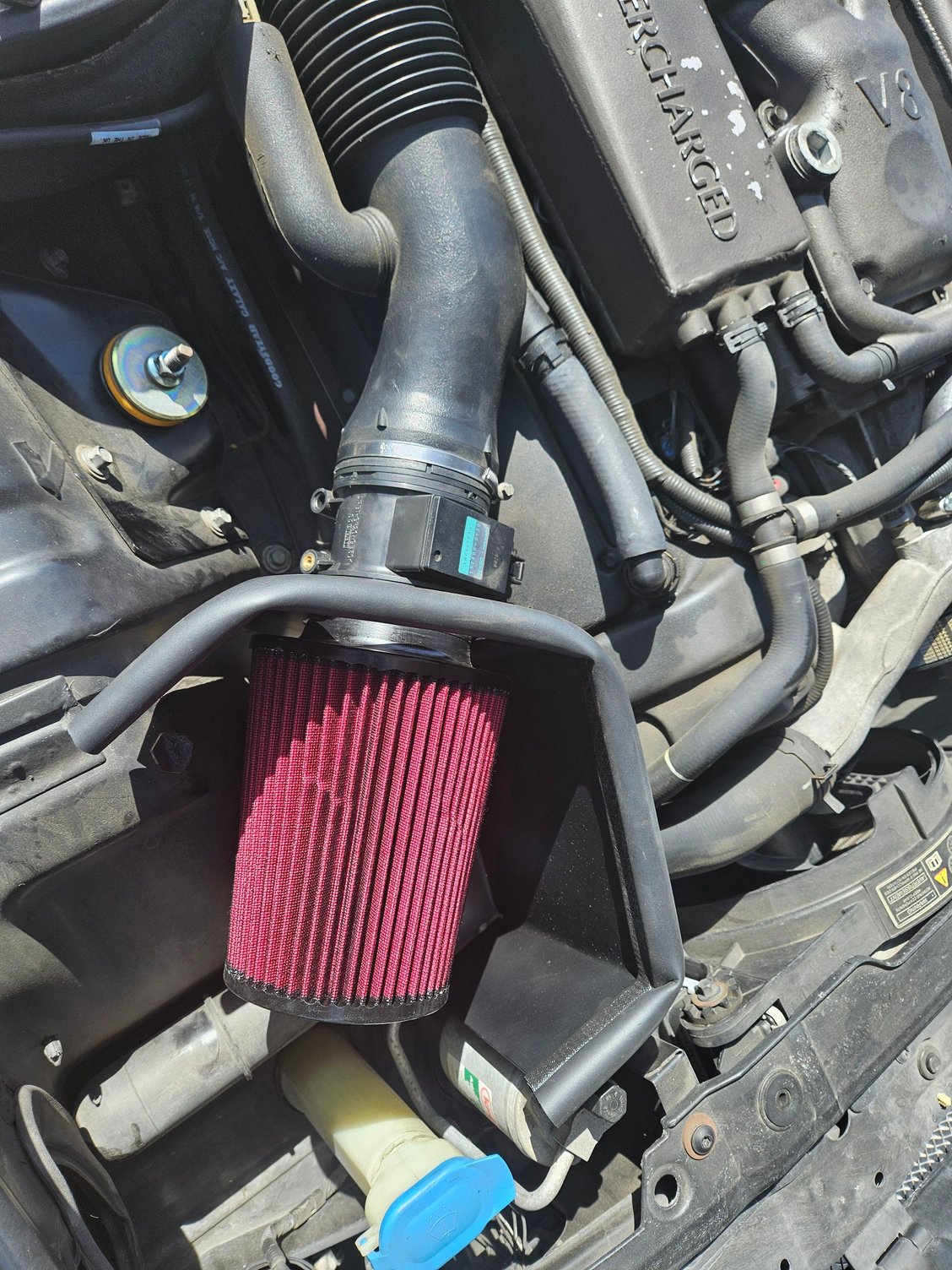

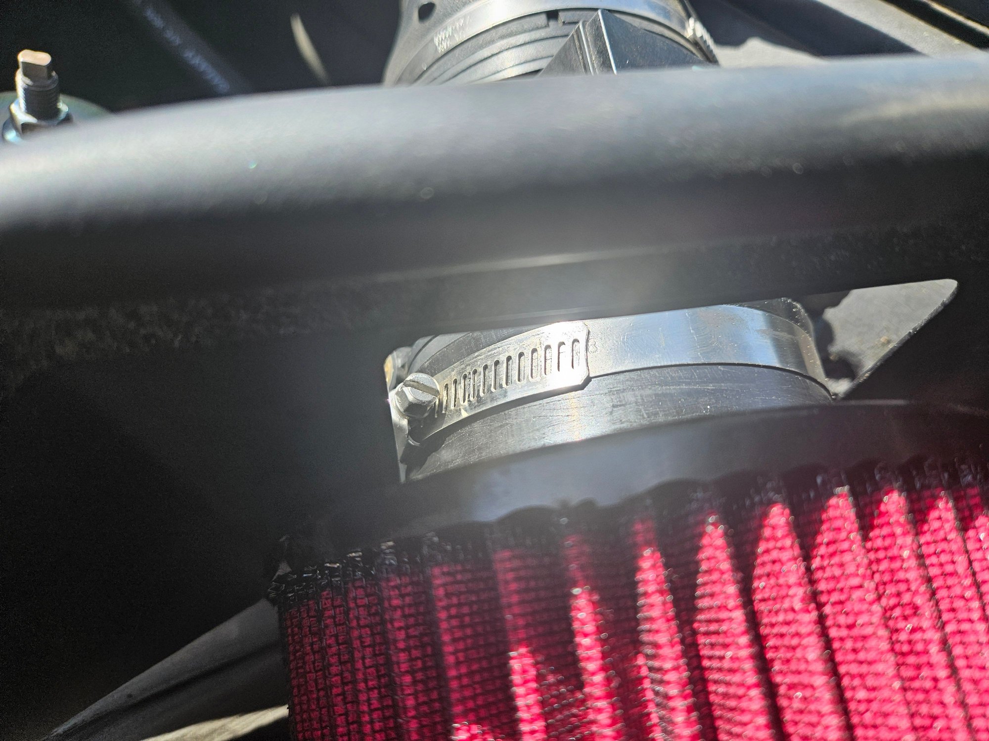

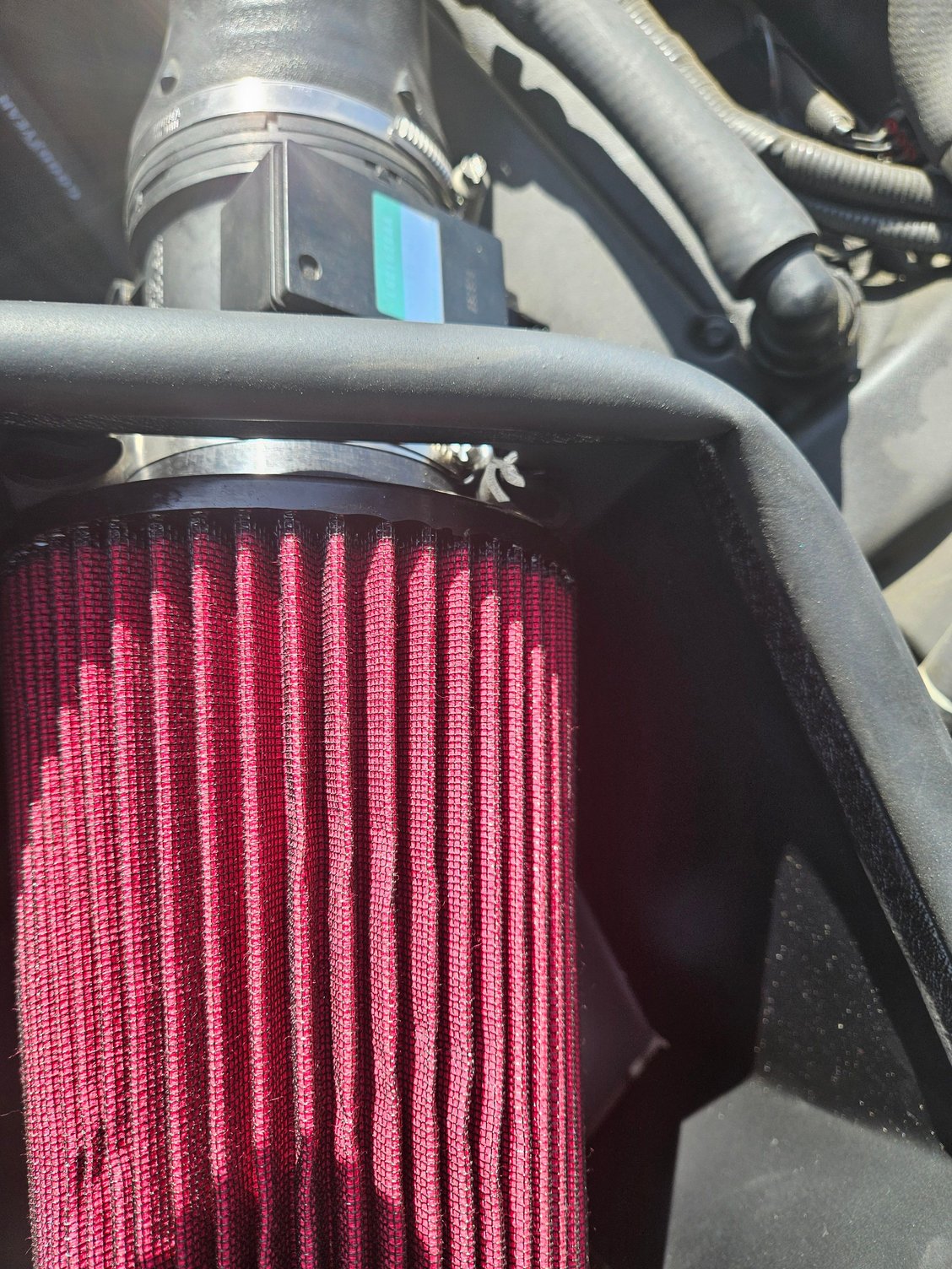

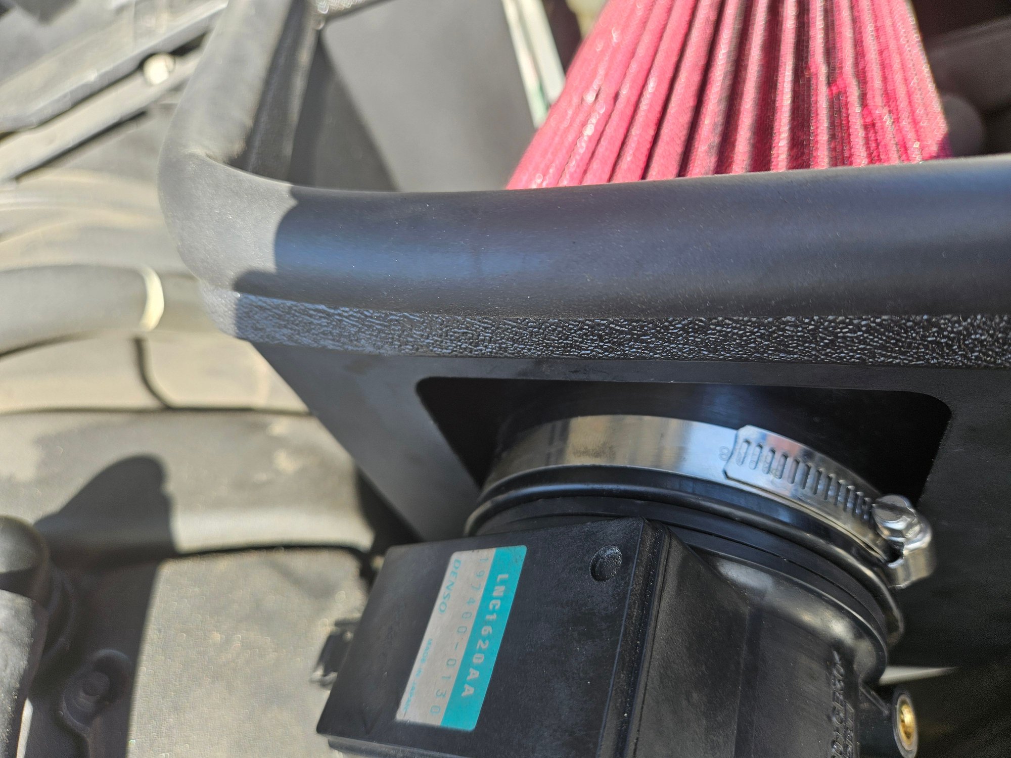

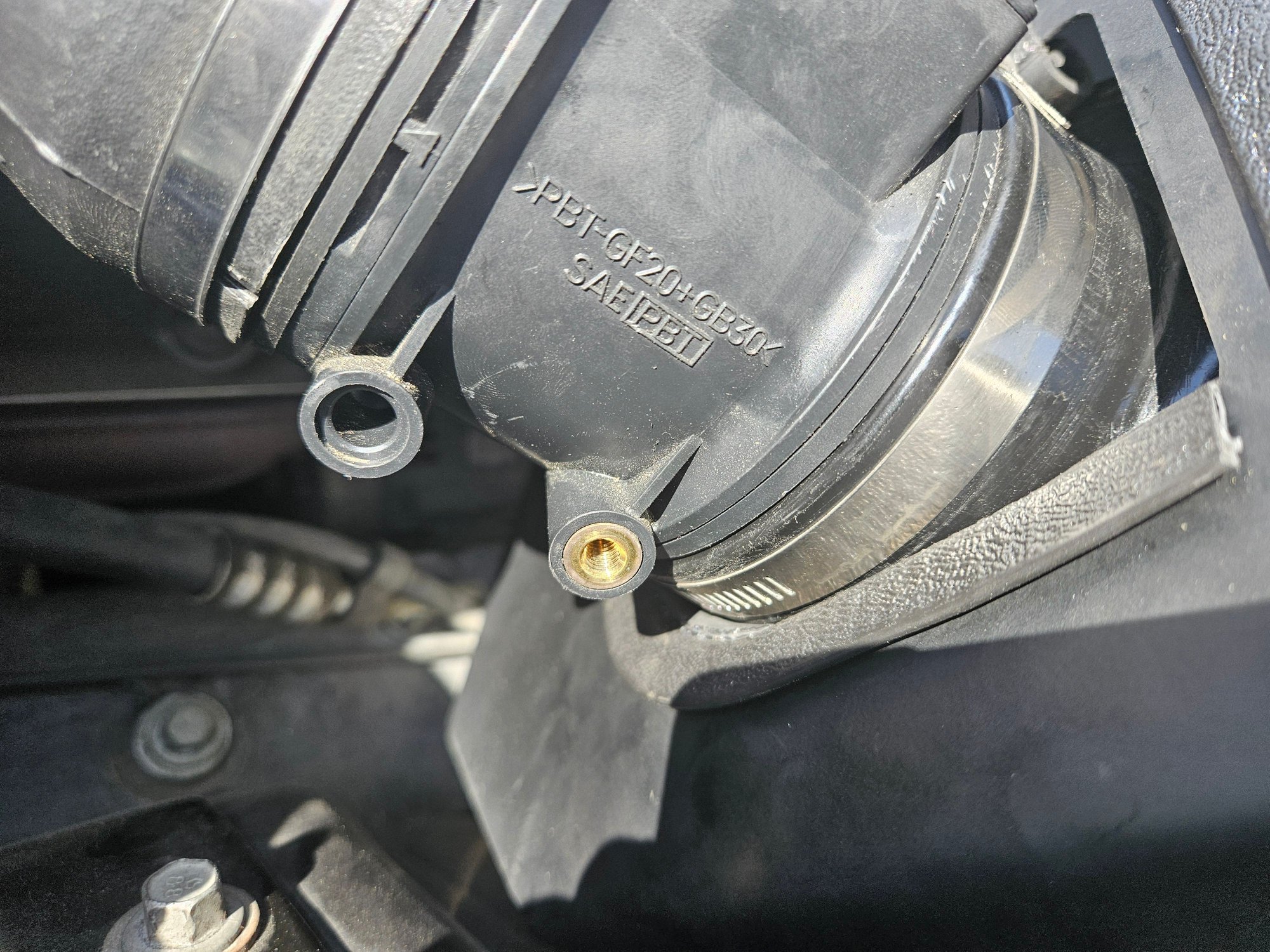

Installed the direct intake today and to be honest felt more like the 49 dollar honda civic special. The main issues besides the heat shield being floppy doppy (I'm assuming not so much with the hood or bonnet closed) is it really feels as though it's missing a piece. The filter (which is different than what's pictured in their ad) they want direct clamped to the MAF. Not the biggest issue minus the fact it don't fit through the cutout in the heat shield also leaving the sensitive MAF not hard mounted and also just kinda there.
It's nice that there is an option for this vehicle (kinda) but it really needs a coupler or extension pipe from the MAF to the filter. The filter also doesn't sit ideal. Instructions were also fairly lacking but living my past life as a FoMoCo tech poor or lacking instructions doesn't fase me much.
All in all it's installed and seems to function and I'll probably be leaving it. Just an honest review for anyone who may find it helpful.
(I bent the filter slightly man handling the thing to try and get it mounted)
