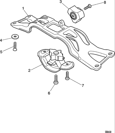

Don't forget to change the transmission mount (#2) as well, that is more often a cause of vibrations.
Yes, I just replaced the transmission mount, and the two drive shaft flex joints, and center drive shaft mount to rid the 50-70 vibration, but this is a slight vibration when there is a slight load on the engine when stationary, and inspection seems to indicate that the "pod" motor mounts are "worn beyond specifications".
