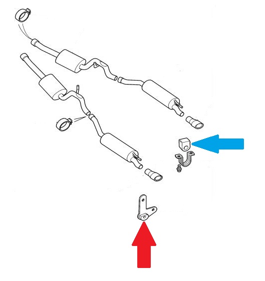

If you eliminate rear wheel bearings, diff and suspension bushes, another cause of resonance is split or missing rubber exhaust hangers (arrowed red and blue) allowing metal-to-metal contact:
One of each of these on each side. The 'L' shaped one is a common failure.
