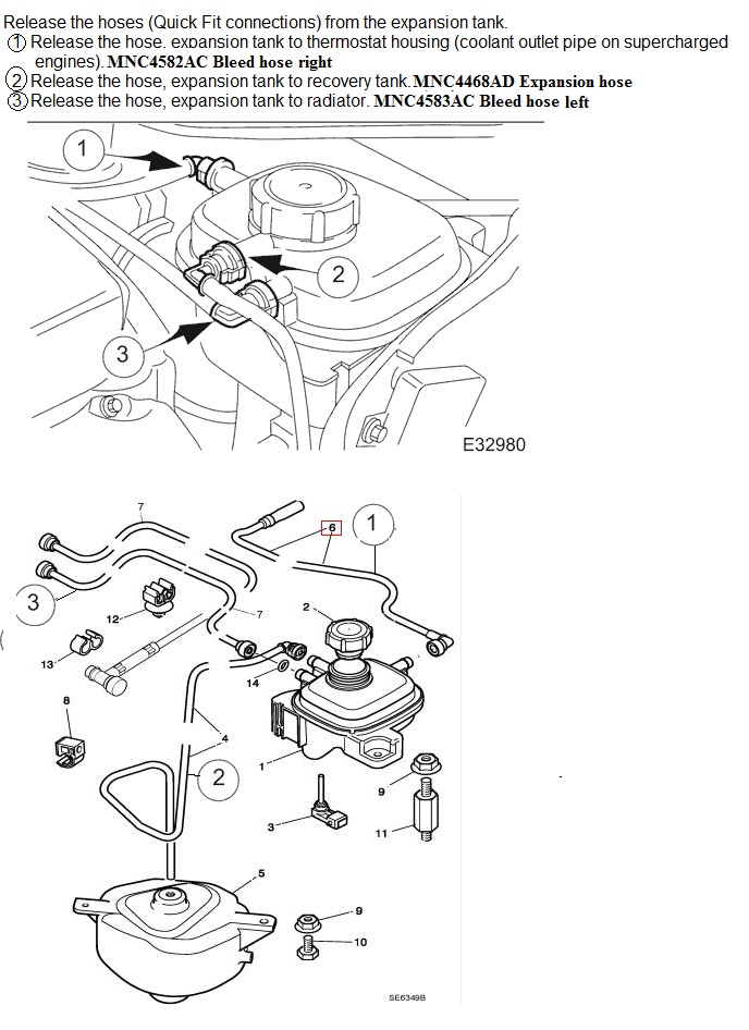

I suspect that you have the common problem of the two hoses on the top of the expansion tank crossed. They should cross over each other, with the one at the tank neck going to the inside of the fender well. There are several pictures on here somewher that shows the correct orientation.

Look at these 2 images of the Coolant Expansion Tank. Both show the arrangement of the plastic hoses (click on image to enlarge it):
Engine Coolant Leak?-xj-x308-coolant-expansion-tank-hoses-images-part-numbers.jpg

"The hoses seem to be fine"
That means they are connected to the expansion tank as in the picture, right?
