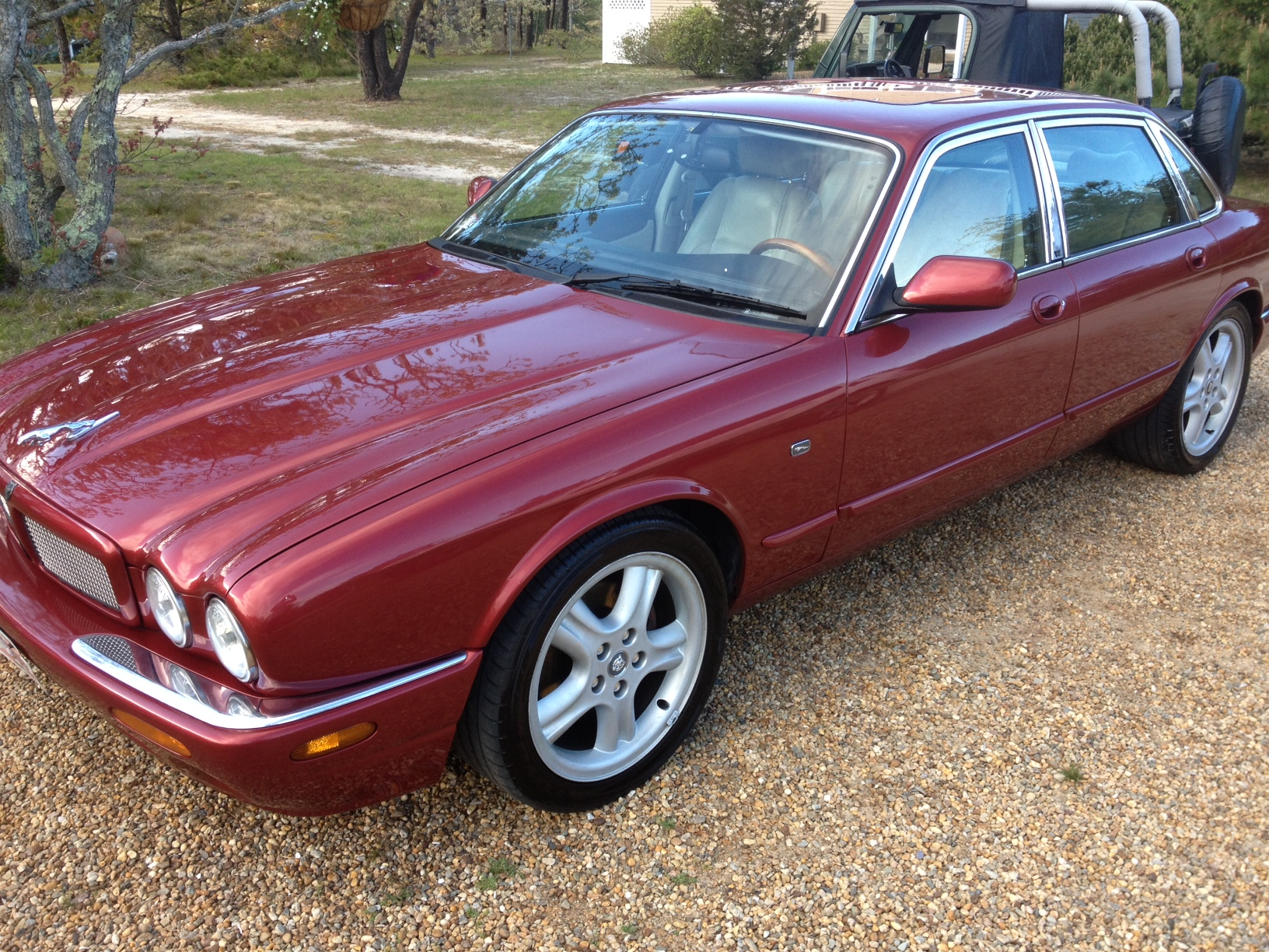

Detailed the car yesterday. The carnival respray is sharp.
