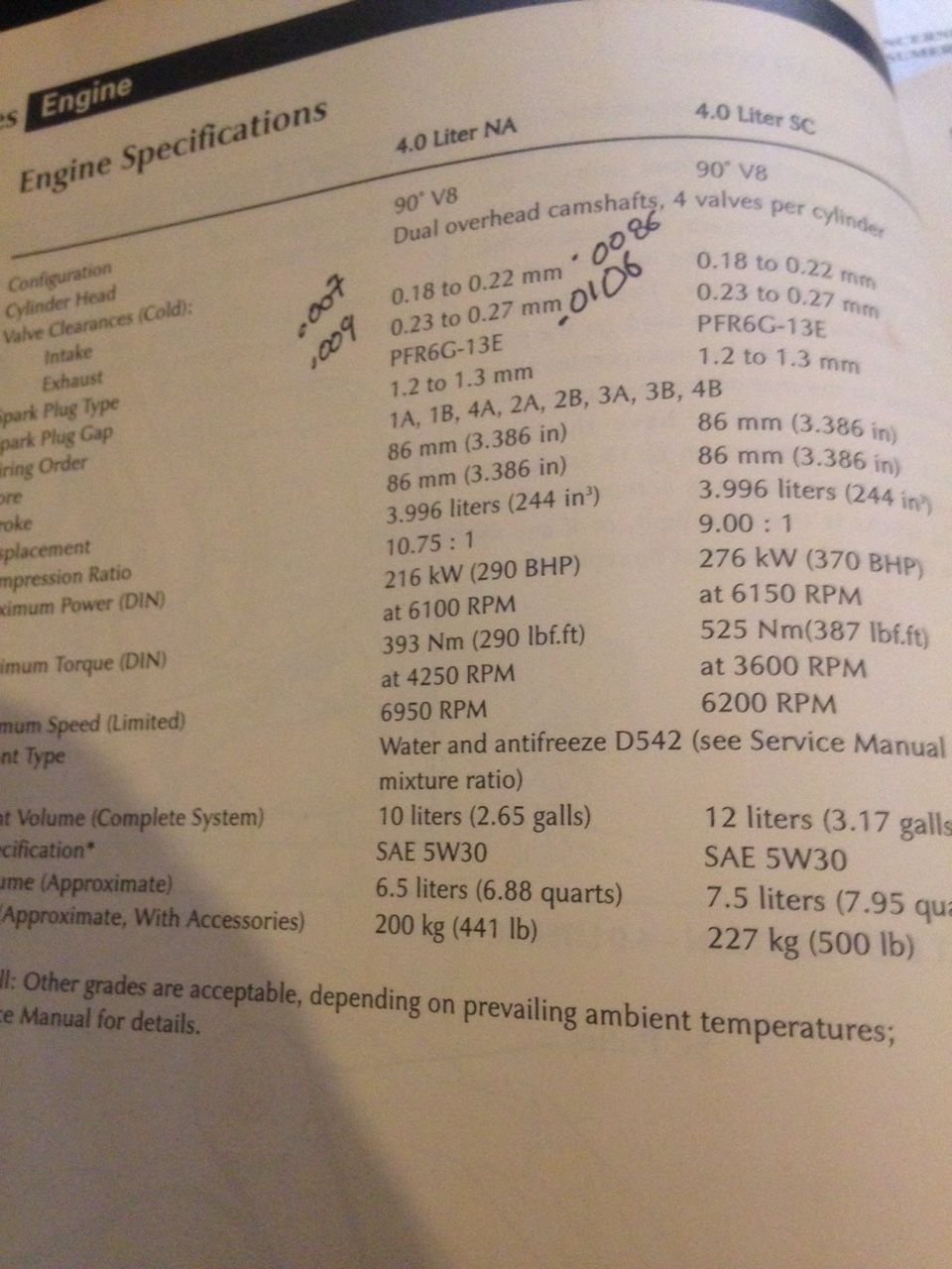

Alot of miss-information out there, XJR and XKR's have a red line around 6200. My Xjr shifts at 5900 just as SeanB stated. From the 1998 tech guide (i have one sitting on my desk)

Thank you for that. Mine shifts at about 6000 as well....thats what was so confusing to me. My cluster showed a 6000 redline, my car shifted at 6000, yet I read 7000. Makes sense now.
