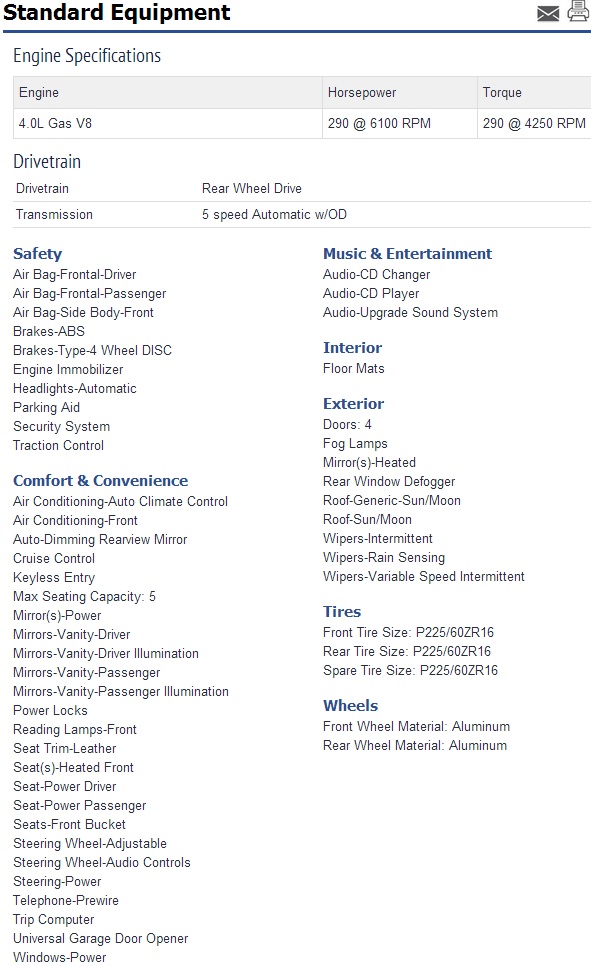

I got this from NADA. I'll look for the checklist as well. Thank you for bringing that up!
