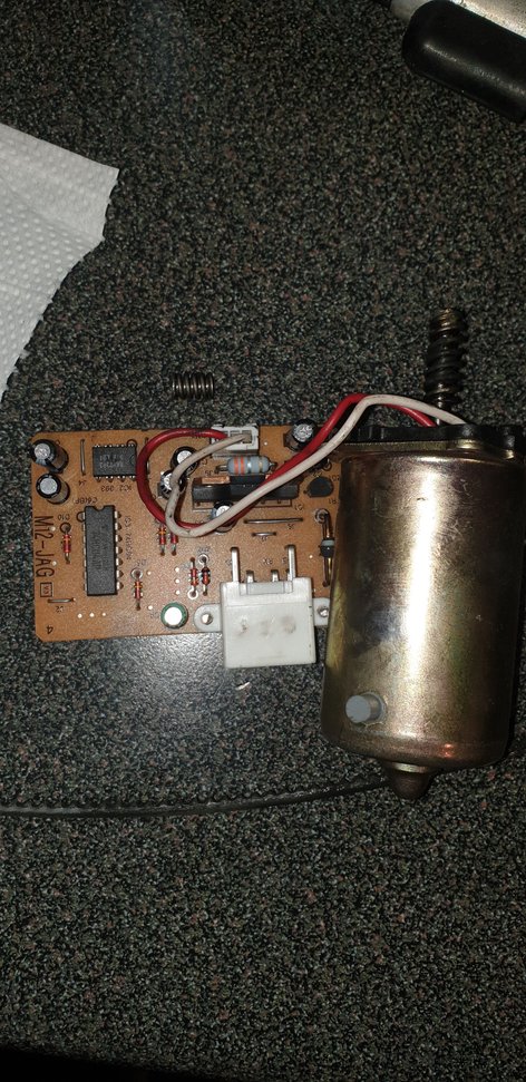

1. Antenna doesn't shut - have removed it and will attempt to fix it. If it doesn't work, I'll purchase a new one.

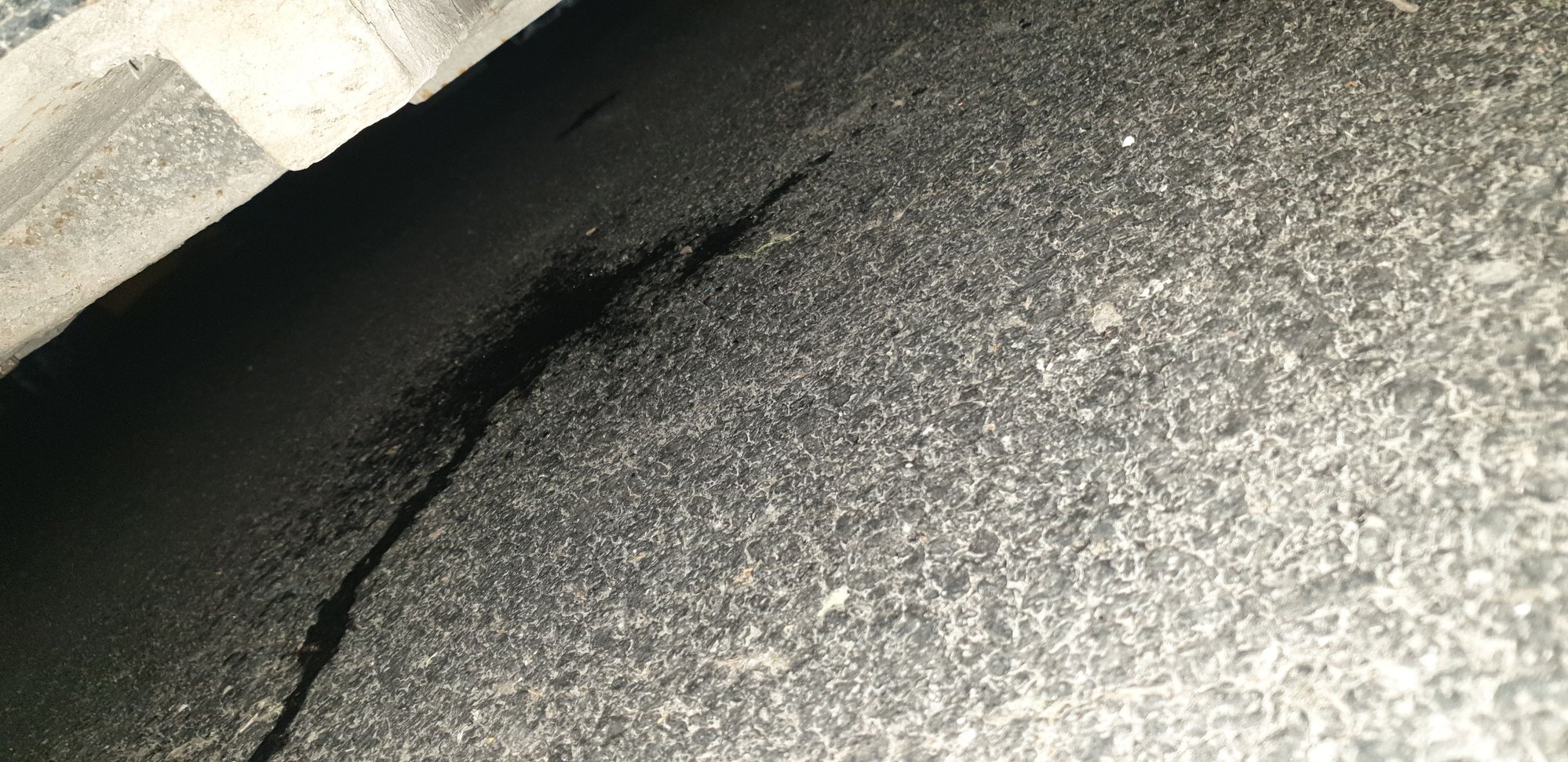

3. Coolant 'leak'. The car was drained of it. Called RAC and the guy was baffled as he refilled it with water and nothing leaked. It has currently been two days and still no signs of a leak.

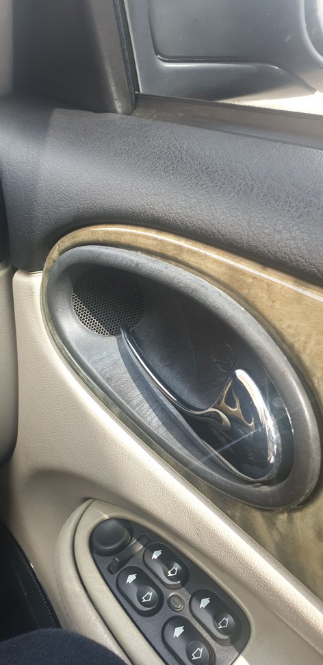

1. The driver door handle is not straight. It's angled a certain way?

For the coolant leak, it simply could of been fluid sitting on top of something and drained off? Obviously keep and eye on it.

The door handle could be a couple of things and the only way to see is to start to remove the cover and card and see if a spring is worn/broke, cable stretched (most likely).... Use another door handle to compare.

As for the coolant, it's happened again. However, the first time it leaked (from the passenger side) - it drained the whole tank.
The leaking now is nowhere near as bad but it is now on the driver's side.
EDIT - one mechanic suggests a leak, another says it could just be the AC unit. Attached is the picture of the leak.
Unrelated, I'm changing the aerial mast. I dropped it on the floor and that spring fell off. Where does it go?

The door handle seems like a small weekend job so I'll start that then.
