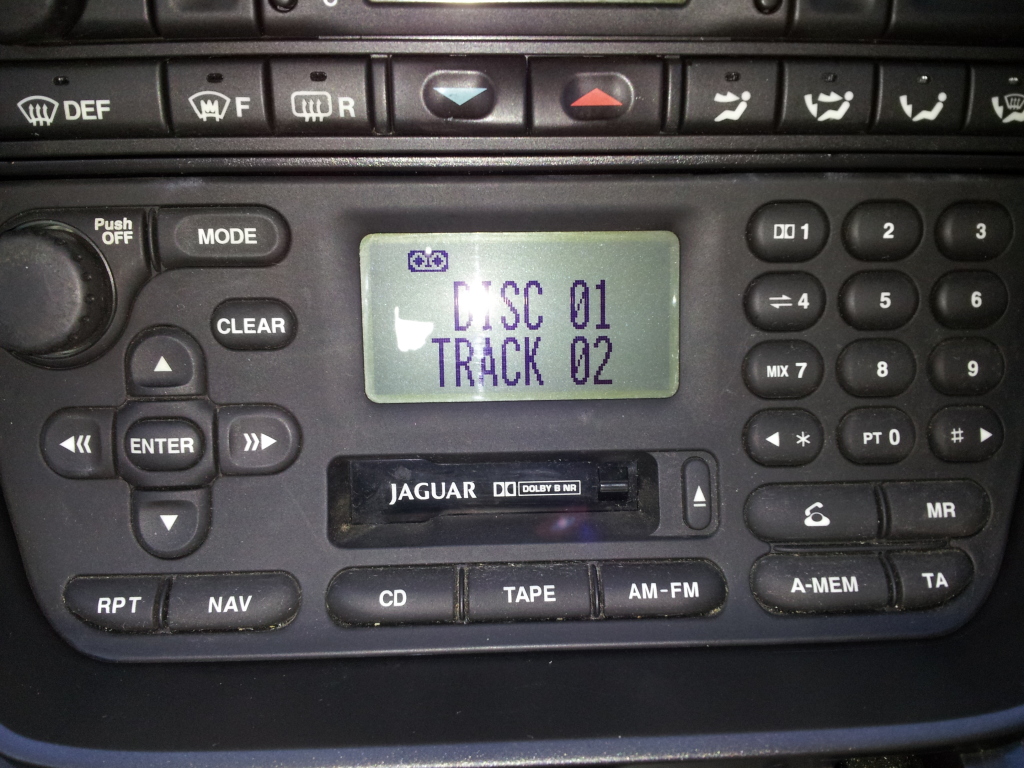

Finally replacement head unit turned up,
and all was well. All that driving around in silence was deafening!
