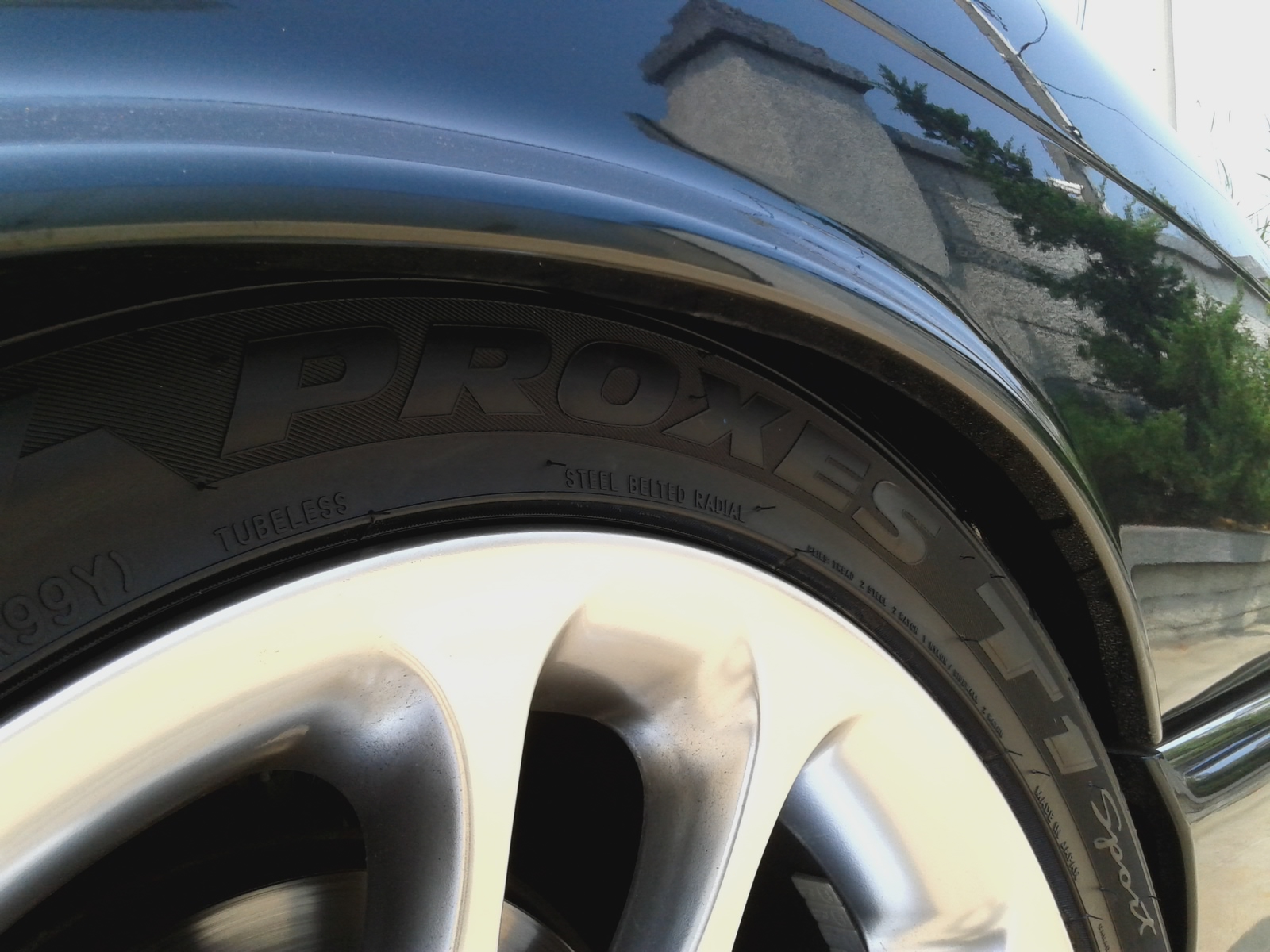

Here a picture of my rear tire at 3/4 travel.
You can't stick a finger between the tire and the lip.
You also see the wheel tilts slightly inward if moving up.
