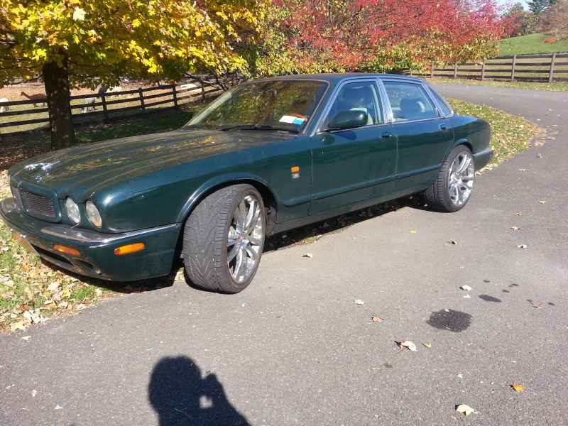

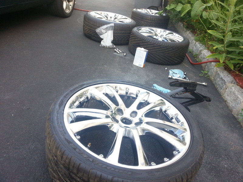

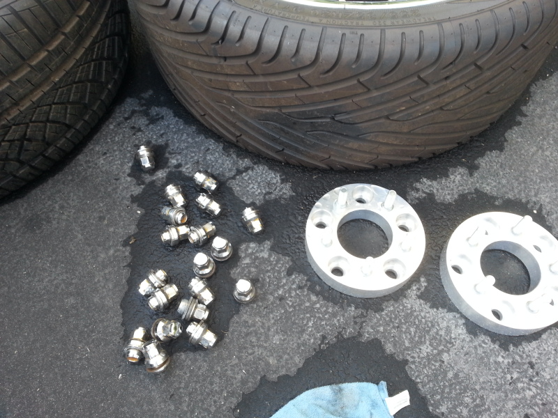

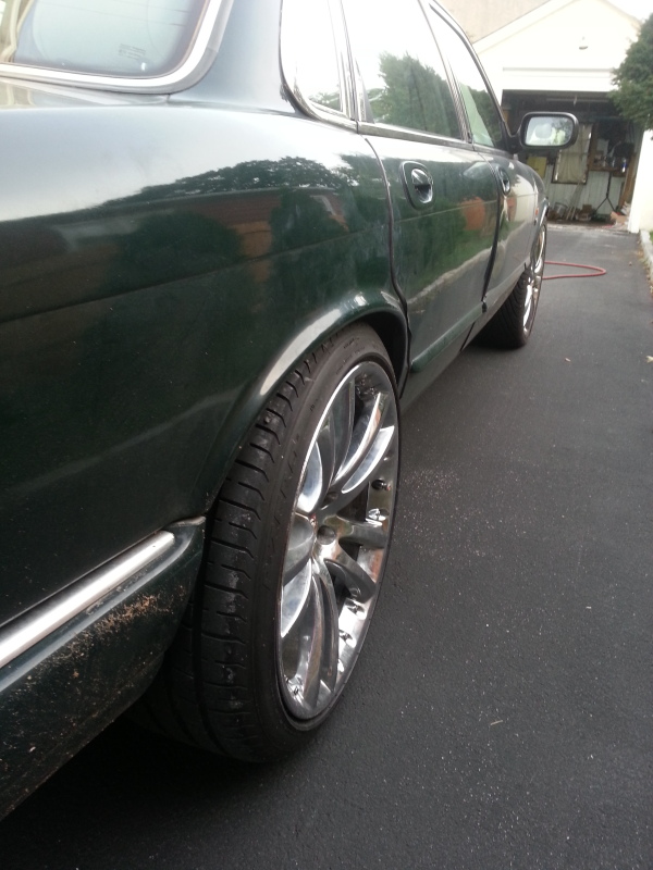

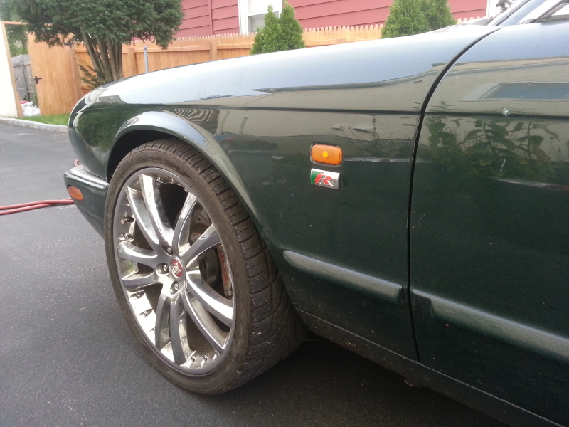

ok, here is my story
I changed from 5X120 Asteroids to 5X108 Chrome Senta staggered 20inch
bolt pattern of course different , I put 1.25 thick adapter with patten conversion,it works perfect fine. but when it comes to the rear. 1.25 was just too thick and rubbing the wheel arch. I also have to changed to 20mm thick but gotta cut the original lug stud by like an half inch or one CM in order to sink in a thinner 20mm flatten
bolt pattern of course is different , I put 1.25 thick adapter with patten conversion for the front wheels ,it works perfect fine. but when it comes to the rear. 1.25 was just too thick and rubbing the wheel arch. I also have to change to 20mm thick but gotta cut the original lug stud by like an half inch or one CM in order to sink in a thinner 20mm flatten
also, the bore-hub is 74mm that I specially order made that
what drives me nuts is find the correct lug nuts. the car has 0.5X20 thread while the adapters I order come with 12.5
