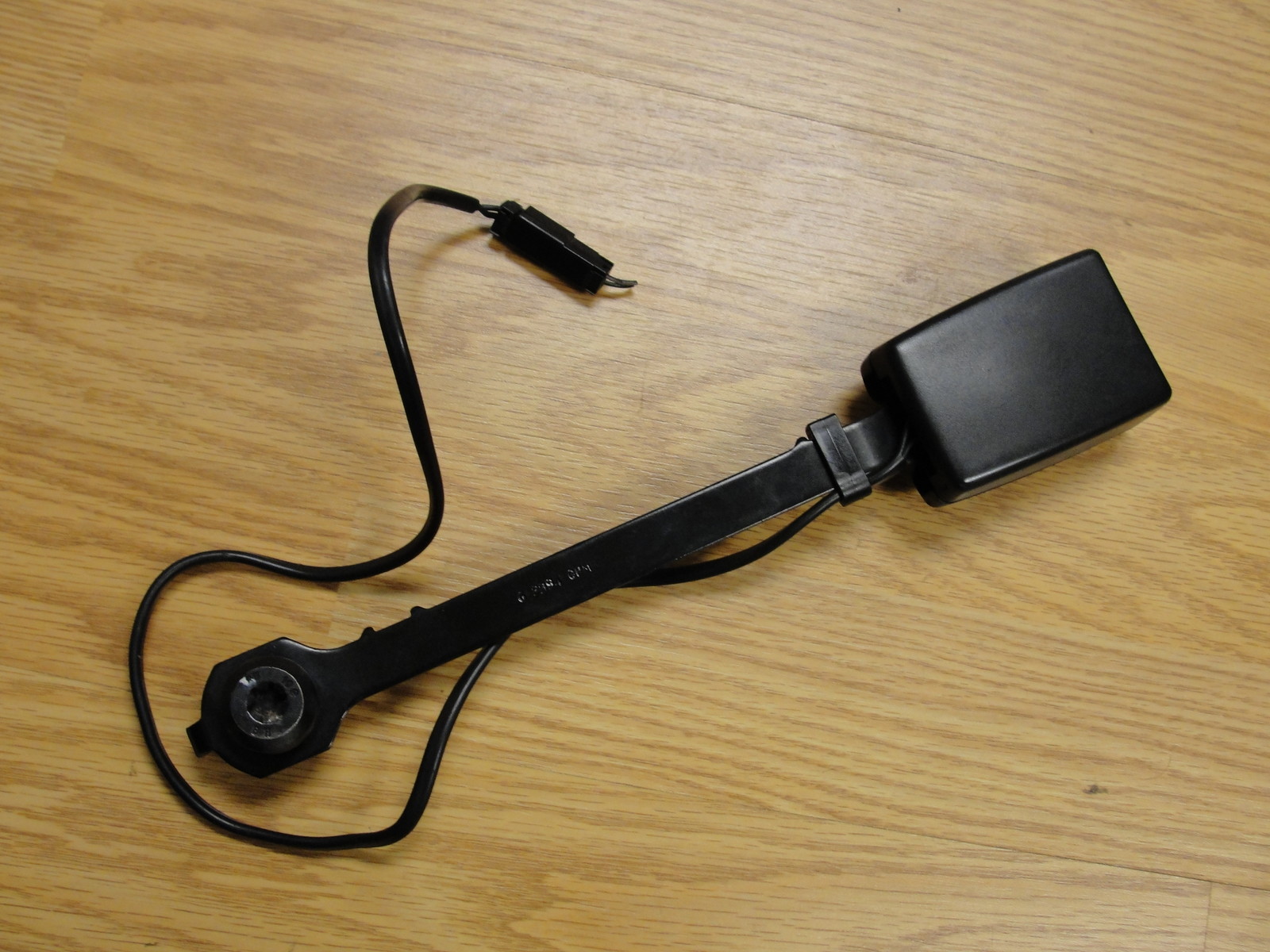

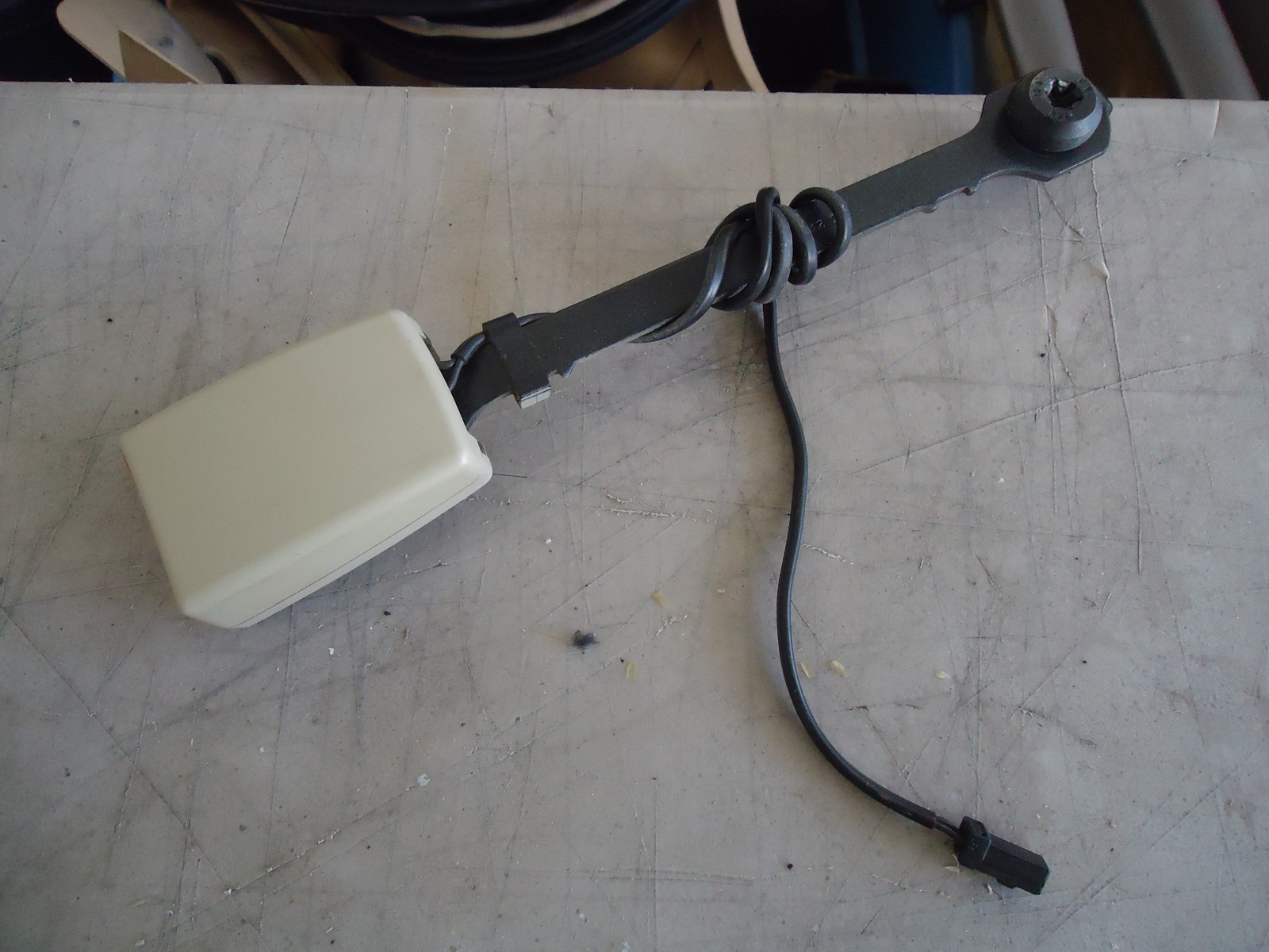

My Wife's VW had the same problem. It was a broken wire in the seat belt where it flexed most. I broke open the seat belt plastic. Soldered in a longer wire to make the fix, and the DING started to work, along with the SRS light going out. Glued the plastic back together with superglue.
It can break inside the buckle, along the mounting down to the floor, or even the plug under the seat can be bad. Look for an area where it would flex MOST. That's likely the culprit area. Then trace the wires till you find the break. OR, buy a replacement belt on Ebay.
Here's an example from Ebay that shows the wire:
http://www.ebay.com/itm/Front-Driver...981af7&vxp=mtr
EDIT: Here's one in Black:
http://www.ebay.com/itm/Jaguar-X308-...16a177&vxp=mtr
