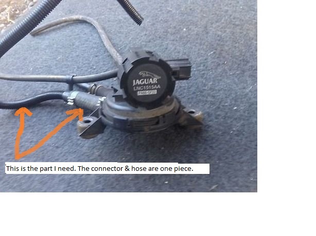

The reason I am asking this question under this topic is I was changing my Octopus hose when I broke this pipe/hose. I have a pretty good image of the part I need. As you can see the hose or pipe is attached to the purge control valve and it is ribbed and goes to a connector on top of the manifold and appears to run under the supercharger and attaches to a sensor on the left valve cover. It is located under the long plastic cover that sits near the firewall and has a hole for the coolant fill cap. I have been searching for this part or just a part number for two months and my 2001 XJR has sat idle because of it.
left valve cover only has one fitting ... part load breather hose connects to it.
the diagrams at jaguarclassicparts.com would have shown it.

Thanks for the reply. As I mentioned it 'appears' to go to the left valve cover. I would have to remove the supercharger to find that out which I really don't want to. The pipe/hose I referenced; see image; gets clipped to a connector that is located in the back of the engine. It is the same type connector that the coolant reserve tank uses and that type connector broke. If I could find this part I can just snap it in there at the rear of the engine just above the manifold. The upper part of the hose is in good shape and that's the end that connects to the Purge Control Valve on the firewall. I have attached .PDF that might help. It is line 3, page 1, in the diagram. I would really like a part number or where I can get one.

I finally found my part. AJ84879
